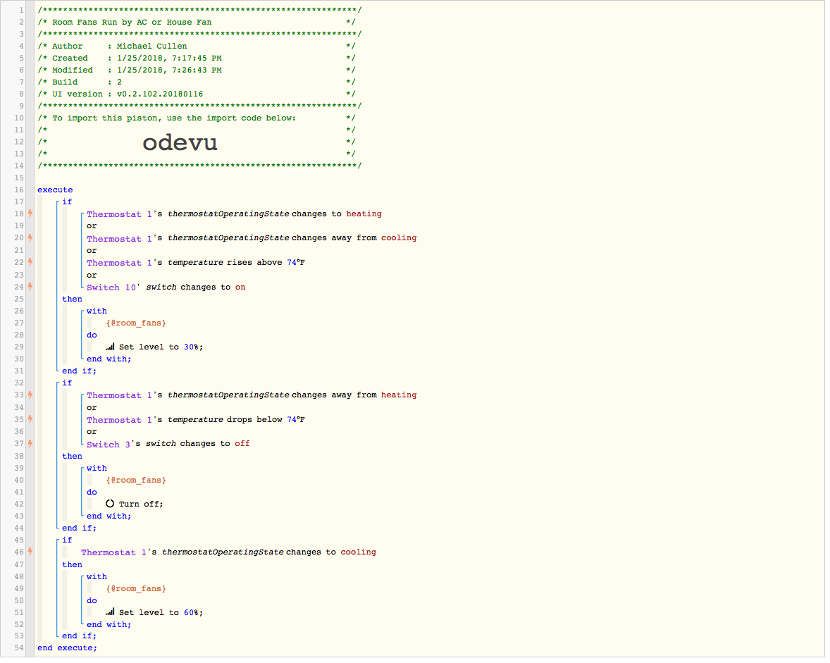

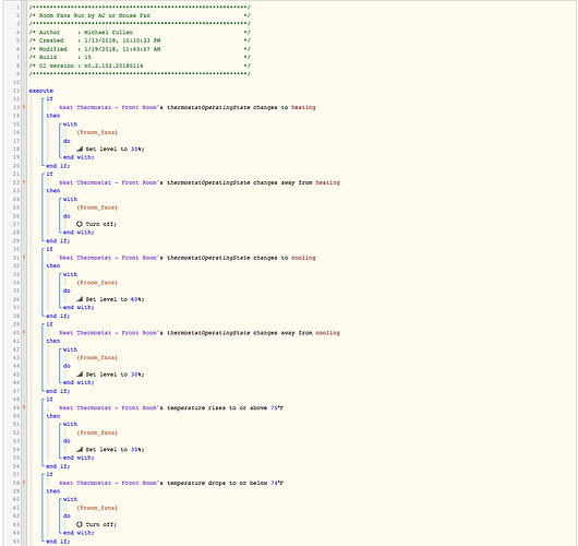

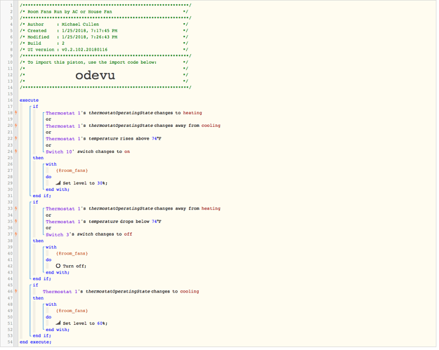

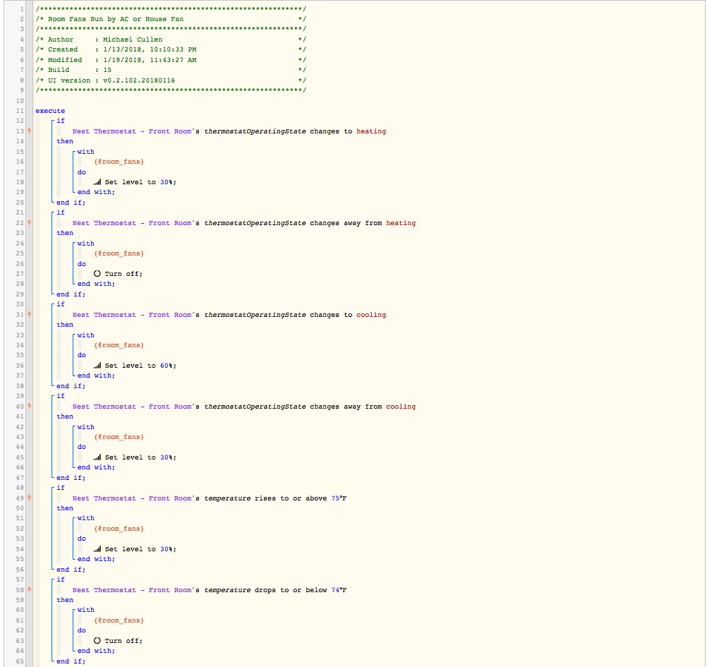

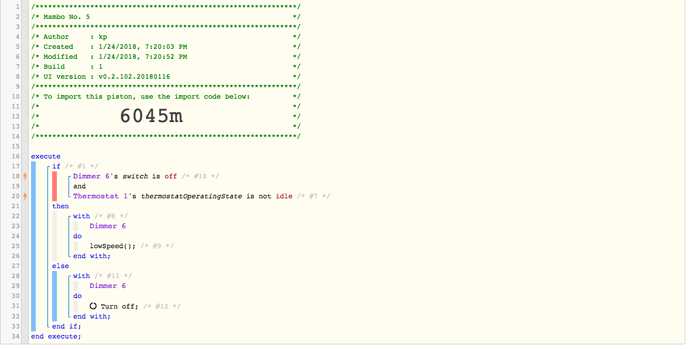

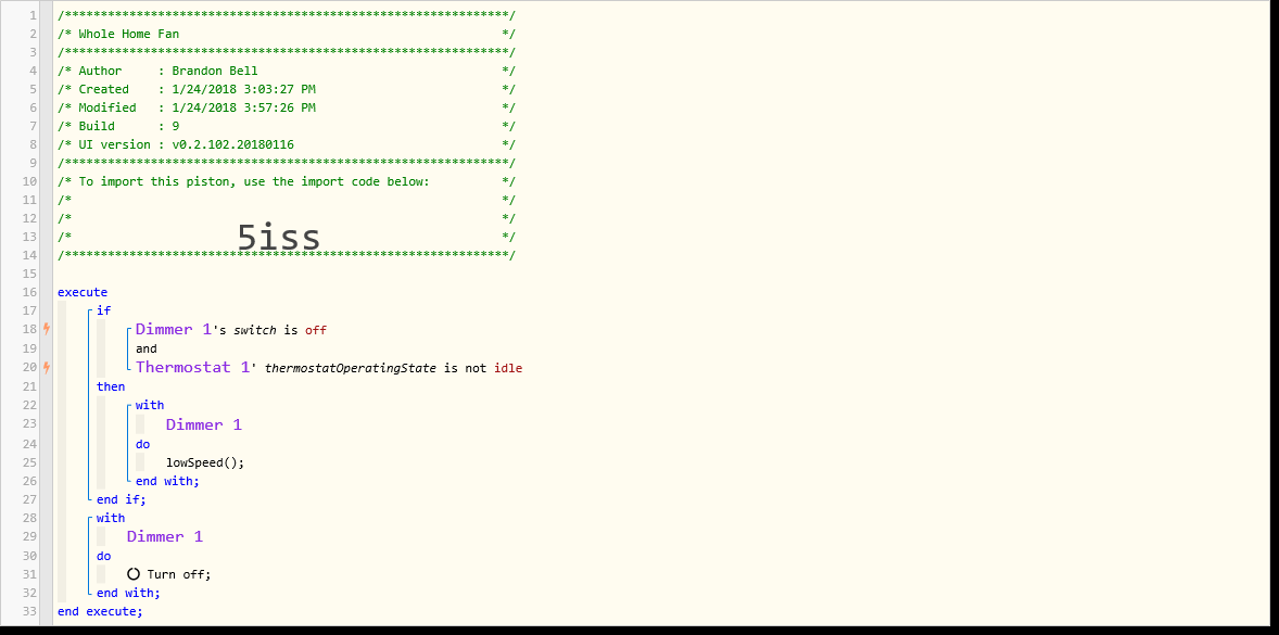

The fan rapidly switches from Low to Off when the A/C is running, or if I change the piston the fan runs but doesn’t turn off.
The fan should turn on to the low setting any time the A/C is running, either hear or cooling, and turn off again once the A/C returns to idle. If the fan is currently in use, it should continue what it is doing. I intend to expand this to the other fans in the house.
When the piston begins to run, the fan rapidly cycles between Low and Off.
