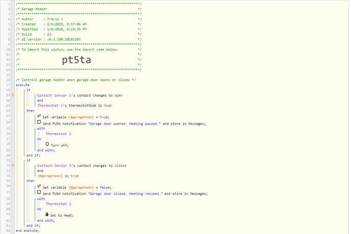

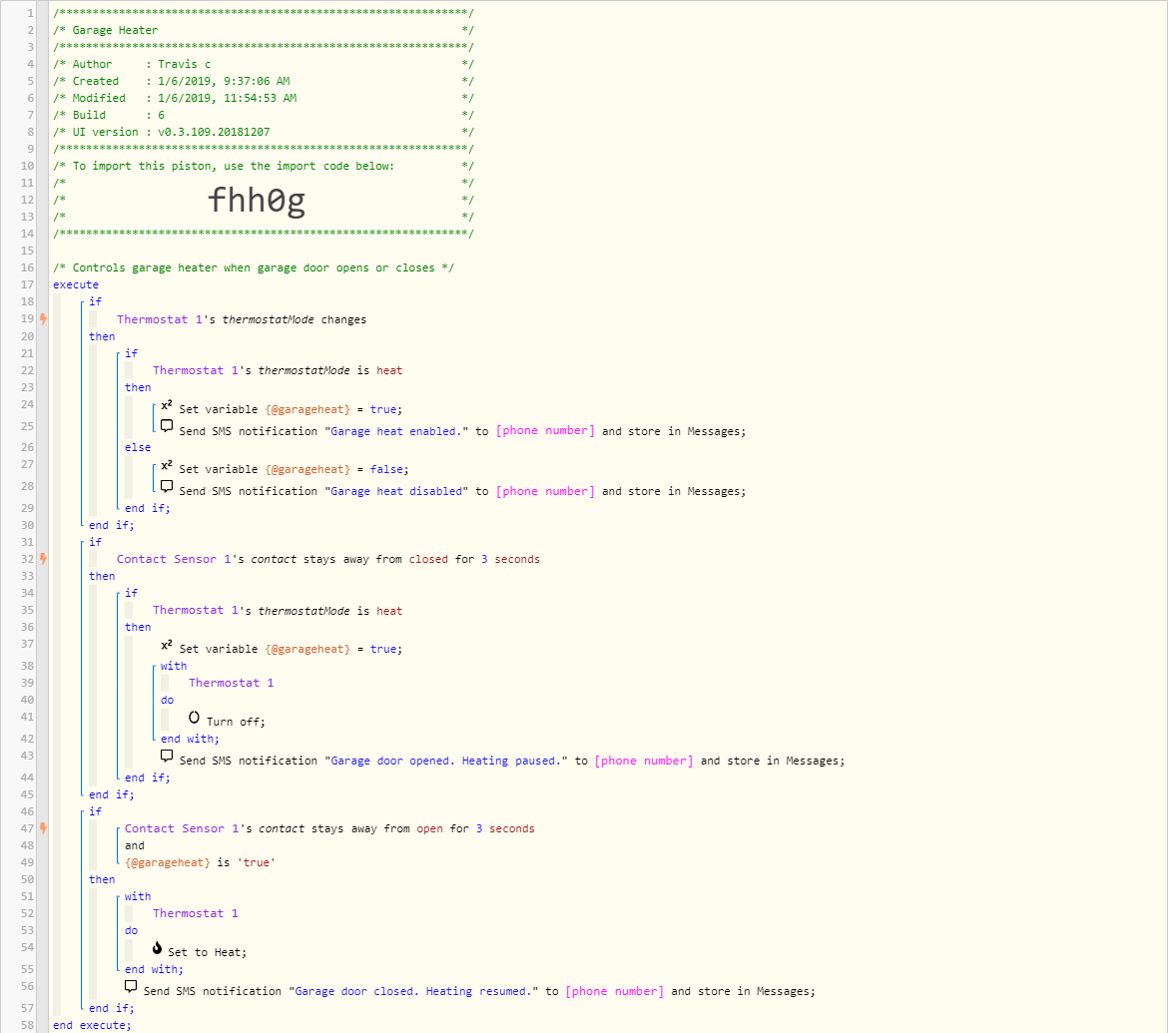

Created my first piston to monitor my garage door and garage heater to pause/resume heating if the door is opened.
Only if the heater is/was on, the heat should pause or resume if the garage door opens or closes. Also send me a PUSH or SMS until debugging is complete.
Doesn’t appear anything is being triggered at all.

Oops, thank you for that. Updated. I’ve noticed the piston state is showing false as well.
Do you have any logs from the last few runs of the triggers?

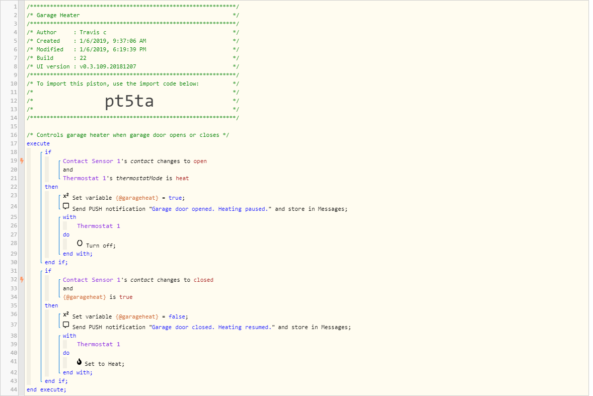

I got it working partially finally… changed my IF statements to “changes to” instead and it’s doing some of the things properly.

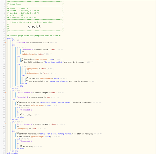

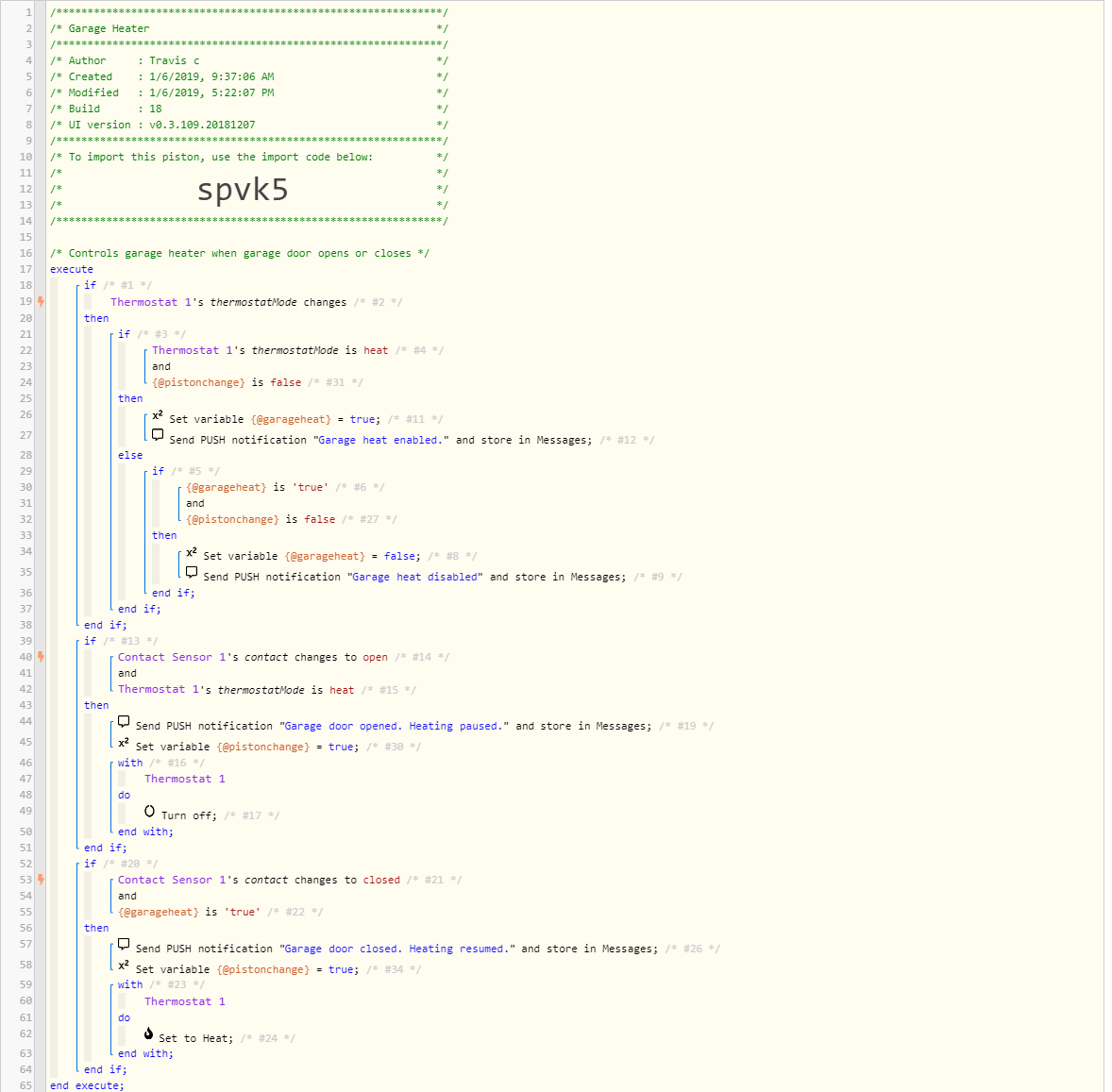

Another confusing question… how can i distinguish between a user mode change and the piston changing the mode?
When I open the garage door, I get the PUSH notification that the heat is paused, and the thermostat is changed to off… Then I get a PUSH notification that the heat has been disabled. Not sure why it’d be doing that, I set variable values to prevent it.
1/6/2019, 5:15:56 PM +78ms
+1ms ╔Received event [Garage Thermostat].thermostatMode = off with a delay of 43ms
+8602ms ║RunTime Analysis CS > 15ms > PS > 8550ms > PE > 37ms > CE
+8604ms ║Piston waited at a semaphore for 8518ms
+8607ms ║Runtime (43054 bytes) successfully initialized in 8550ms (v0.3.109.20181207) (8605ms)
+8609ms ║╔Execution stage started
+8624ms ║║Comparison (enum) off changes = true (1ms)
+8627ms ║║Cancelling condition #2’s schedules…
+8628ms ║║Condition #2 evaluated true (9ms)
+8630ms ║║Cancelling condition #1’s schedules…
+8631ms ║║Condition group #1 evaluated true (state changed) (13ms)
+8641ms ║║Comparison (enum) off is (string) heat = false (2ms)
+8643ms ║║Cancelling condition #4’s schedules…
+8644ms ║║Condition #4 evaluated false (10ms)
+8646ms ║║Cancelling condition #3’s schedules…
+8647ms ║║Condition group #3 evaluated false (state changed) (12ms)
+8656ms ║║Comparison (boolean) true is (boolean) true = true (3ms)
+8658ms ║║Cancelling condition #6’s schedules…
+8659ms ║║Condition #6 evaluated true (9ms)
+8666ms ║║Comparison (boolean) false is (boolean) false = true (2ms)
+8668ms ║║Condition #27 evaluated true (7ms)
+8670ms ║║Cancelling condition #5’s schedules…
+8671ms ║║Condition group #5 evaluated true (state changed) (21ms)
+8675ms ║║Cancelling statement #7’s schedules…
+8681ms ║║Executed virtual command setVariable (1ms)
+8700ms ║║Executed virtual command sendPushNotification (13ms)
+8713ms ║║Cancelling condition #14’s schedules…
+8714ms ║║Condition #14 evaluated false (9ms)
+8716ms ║║Cancelling condition #13’s schedules…
+8717ms ║║Condition group #13 evaluated false (state changed) (12ms)
+8728ms ║║Condition #21 evaluated false (6ms)
+8729ms ║║Condition group #20 evaluated false (state did not change) (9ms)
+8733ms ║╚Execution stage complete. (123ms)
+8734ms ╚Event processed successfully (8734ms)

Was able to simplify it. This will do the trick.
