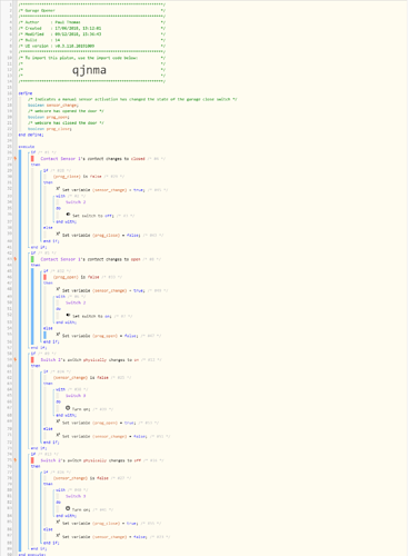

This is a piston for one of my garage doors. I’ve been using a rendition of this piston for about 2 years but I’ve never been able to get the “Door Check” portion of it working properly. First, let me explain my setup.
I was using this before you could get cheap z-wave garage door openers so I’m using a Z-Wave relay wired into the garage door clicker and ST Multipurpose sensors on the garage doors.
This piston works in general but the problem I’m having is that the notifications in the “Check to see if door closed properly” section are not working. When the “CloseGarageDoor” variable changes to true the door actually closes and does so successfully most of the time. The problem is that my door check isn’t working. I never get a notification telling me if the door closed or didn’t close. I suppose it’s possible that I shouldn’t be using nested IFs since the “Push” command works for the relay but it never gets pass that part to execute the nested IF.
Although I’ve been using Core/Webcore for a couple of years I’m still sort of new to coding within it so I’m guessing this entire piston should be re-written for better efficiency.
I’m expecting to receive a notification telling me if the door closed successfully or failed.
The notification is never sent.
