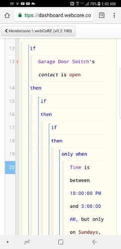

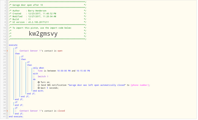

(If I run the Piston and hit the test button it closes the door after 10 but if I don’t hit the test button it doesn’t close the door. This is my first piston)
(Close the garage door if left open after 10 and send an SMS )
(Piston is running but not closing the door after 10 if it’s open)
webCoRE
Hendersons \ webCoRE (v0.2.100)
Garage door open after 10
Status
This piston is currently active and humming happily.
Pause »
Piston category
Uncategorized
Quick facts
Piston state: true
Last executed: 12/24/2017, 10:31:35 PM
Next scheduled: never
Subscriptions: 1 event, 1 control
Devices used: 2
Memory used: 35% (34575 bytes)
External URL: (click to open/execute)
Automatic backup
Automatic backup is enabled for this piston.
Touch the box below to reveal your backup bin code. You should make a note of this code as you may use it later to restore a piston that you “mistakenly” deleted.
i0xx
Please do NOT share this code with anyone.
Script (hide)
/* Garage door open after 10 */
/* Author : Barry Henderson /
/ Created : 12/24/2017, 12:40:52 AM /
/ Modified : 12/24/2017, 10:17:03 AM /
/ Build : 9 /
/ UI version : v0.2.100.20171211 */

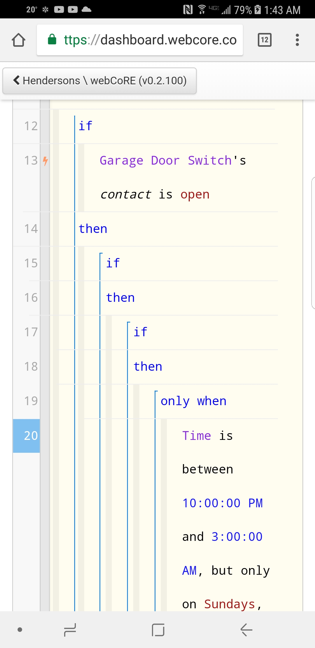

execute
if
Garage Door Switch’s contact is open
then
if
then
if
then

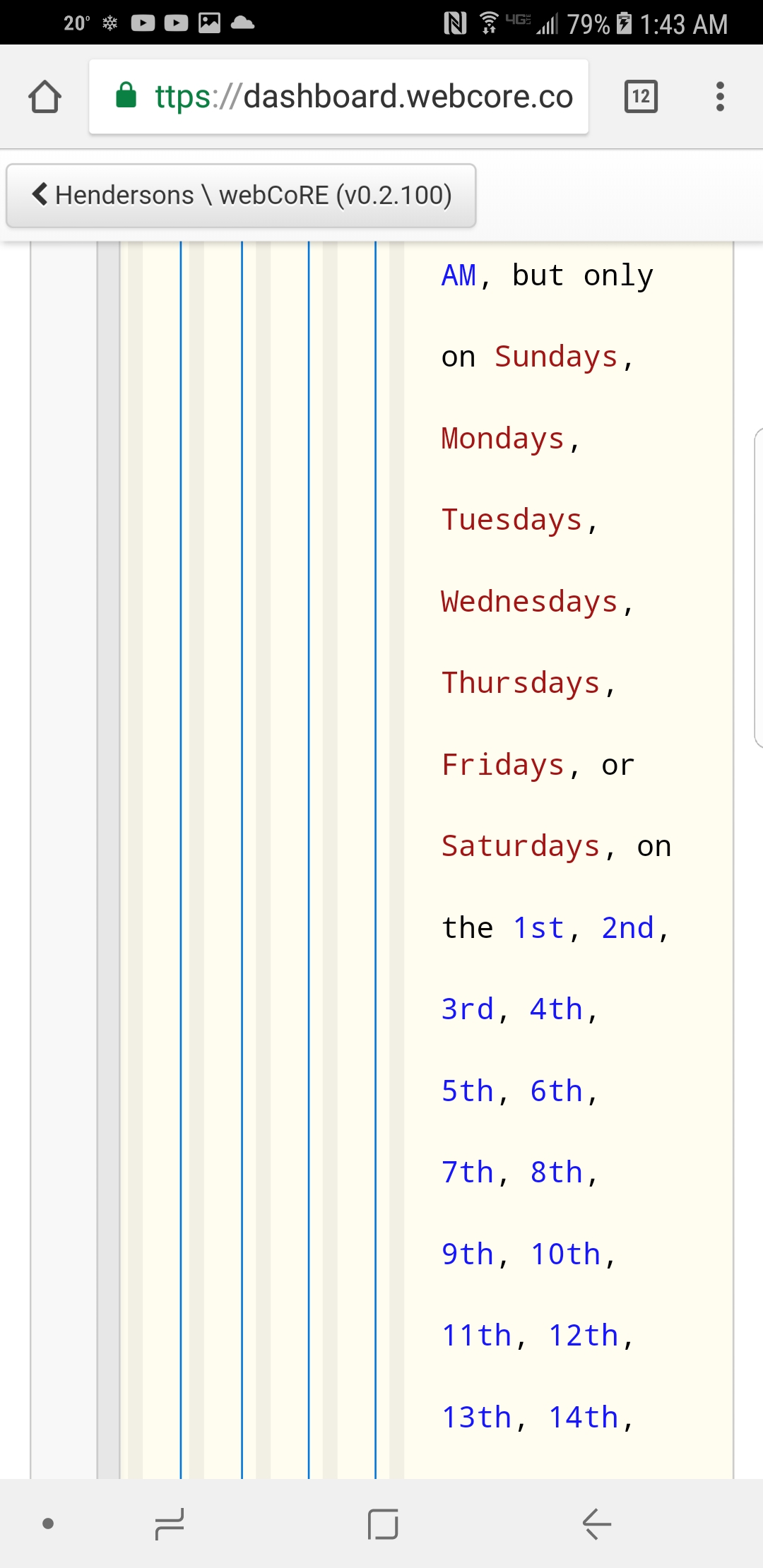

only when
Time is between 10:00:00 PM and 3:00:00 AM, but only on Sundays, Mondays, Tuesdays, Wednesdays, Thursdays, Fridays, or Saturdays, on the 1st, 2nd, 3rd, 4th, 5th, 6th, 7th, 8th, 9th, 10th, 11th, 12th, 13th, 14th, 15th, 16th, 17th, 18th, 19th, 20th, 21st, 22nd, 23rd, 24th, 25th, 26th, 27th, 28th, 29th, 30th, 31st, last, second-last, or third-last days of January, February, March, April, May, June, July, August, September, October, November, or December

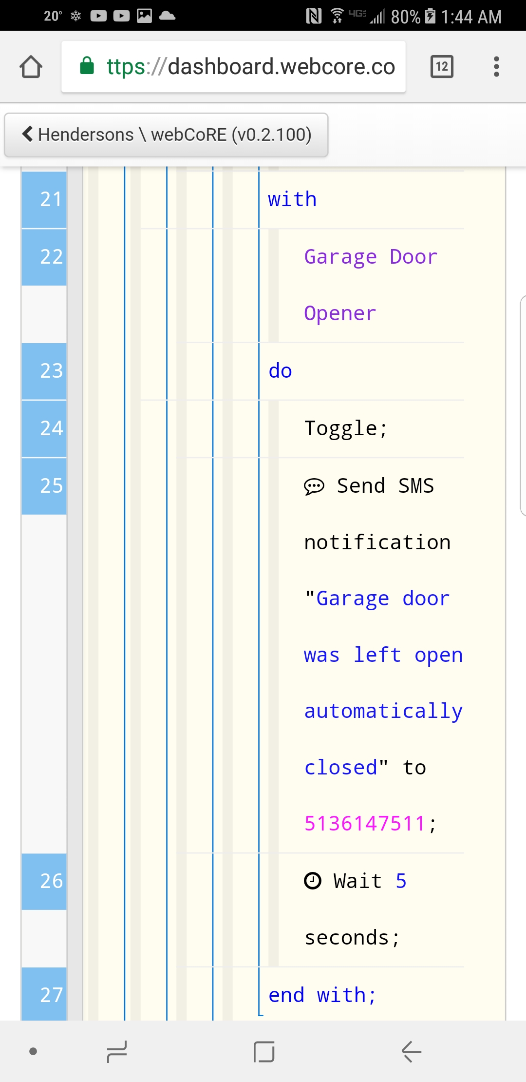

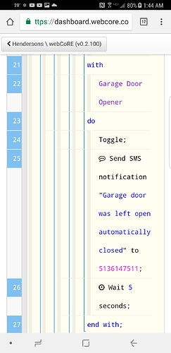

with
Garage Door Opener
do
Toggle;
Send SMS notification “Garage door was left open automatically closed” to xxxxxxxxxx;
Wait 5 seconds;
end with;
end if;
end if;
end if;
if
end if;
if
Garage Door Switch’s contact is closed
end if;
end execute;
Edit » Test TraceTrace Delete »
