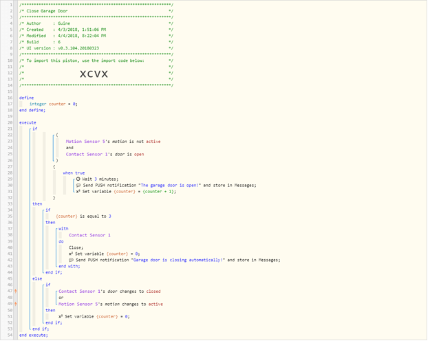

I would like to close my garage door automatically after 3 messages are sent to my cell phone. I have a motion sensor that detects if there is someone inside the garage and it would stop the whole process until there is no one inside the garage and the door is still opened.
I would receive 3 messages before the garage door is closed automatically.
I’m receiving just one message and the garage door is not closed automatically.

Not sure about the contact sensor controlling the door . . .
But separate of that, I think there is an issue with your counter. It starts off at 0 and then increments to 1 when the first set of conditions are met. So now that your counter is at 1, the first THEN statement is skipped because the counter is not =3.
So the logic proceeds to your ELSE statement, which is where I think the logic goes into a black hole. At this point your door is still open and there probably isn’t motion, so neither of those test as true, and you’re done . . .
Off the top of my head I’d say that you need to test for counters equaling 1, 2 and 3 and provide appropriate actions for each.
Also, you may find that in your last IF statement, the contact should be IS closed, not changes to closed.

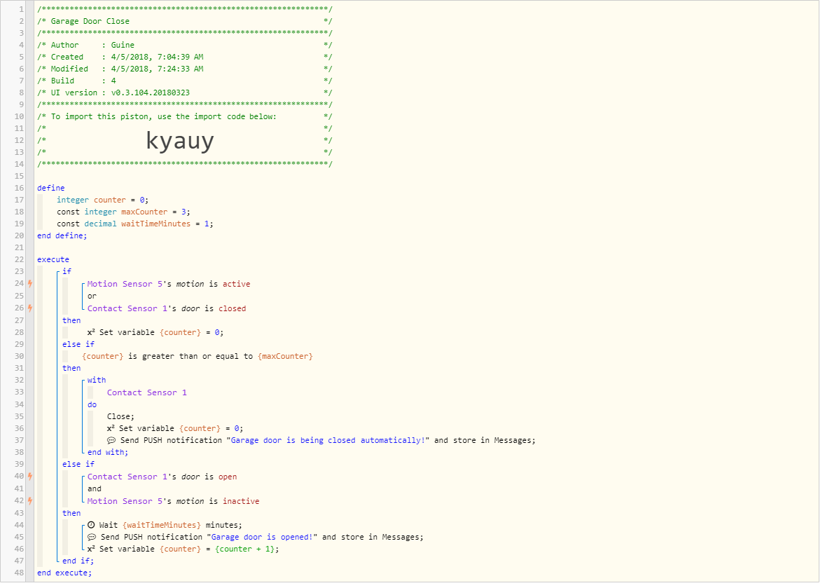

Hi!
I did and it worked :slight_smile:
I changed the order of execution. Could you please take a look? I’m going to test it tonight.
This one made my head hurt, lol. I’m thinking it might work but I’m not sure.

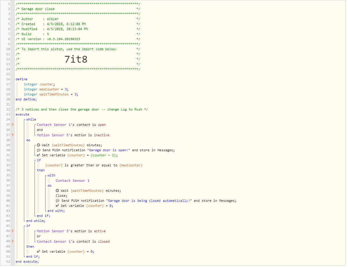

It may be more complicated than you need. You are using counters and loops to get you multiple text messages that I THINK could be done in one block with some waits in between. Just check for motion again before you shut the door.
Give it a shot and let’s see what happens.
Just if anyone has the same issue I did, this is the final code provided by eibyer. Thank you eibyer!
