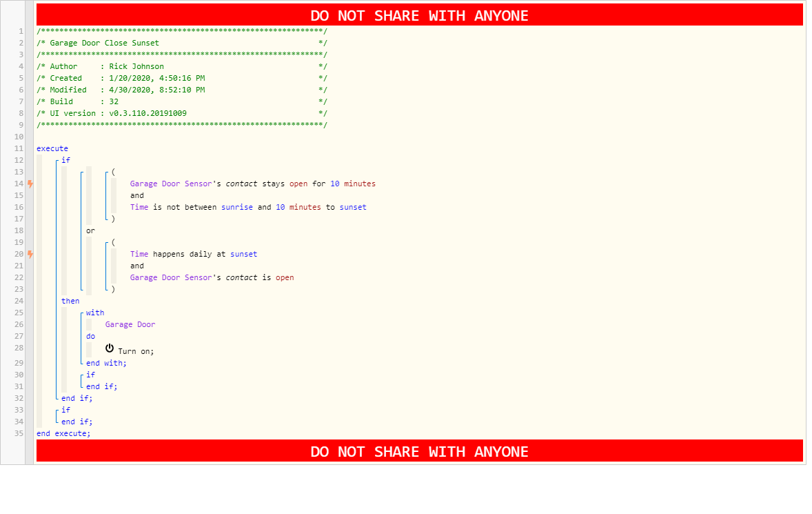

Im still having trouble with my piston closing the door at sunset if the contact sensor is open.
I have added the second or
Time happens daily at sunset
and
Garage door sensors contact is open
That should take care of closing the door at sunset
Today the garage door was opened late afternoon when the time pasted sunset I don’t understand y the door didn’t close
The piston states
Garage door sensor contact stays open for 10 min
and
Time is not between sunrise and 10 min to sunset
Any pointers

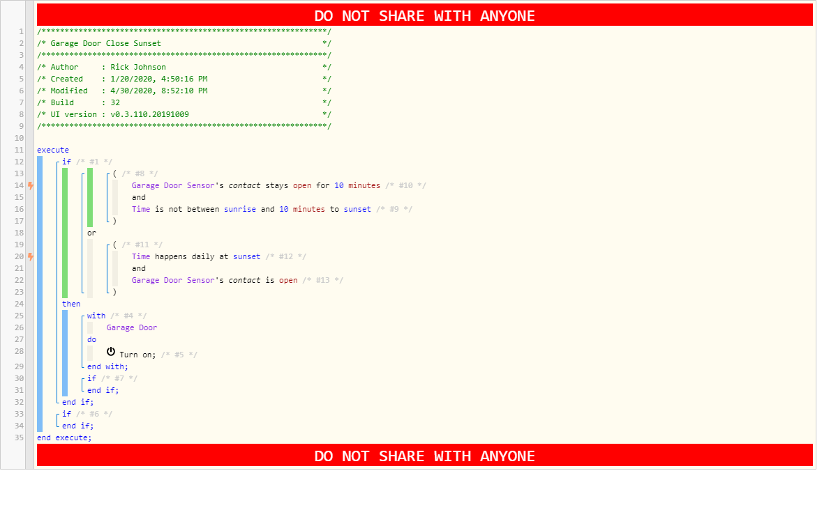

Did you logs give you any clue as to what is happening?
At 7:36 should there not have being a schedule to start the piston at sunset around 8:22(sunset) as the door was open. Even log for 8:52 why is the schedule for the next day when the garage door sensor is open at the time

If you turn on Trace, your log will make more sense…
Doesn’t ‘turn on’ for the garage door mean ‘open’? Not sure what type you have but that is how mine works.
The 7:36 log looks like the wake up from the ‘stays open’. I’m not sure if the scheduled task would necessarily show up there but I’d certainly expect there to be one regardless of anything.
The 8:52 is the piston starting up after being edited or restarted. It is just deciding what device events to subscribe too (the Garage Door Sensor) and whether it needs to schedule any runs immediately (next day at sunset for the happens daily).

Have you tried just making a piston that just executes the commands ‘turn on’ or ‘turn off’ as a test to be sure they work? What device/DTH are you using to control the garage door? It may not support turn on/off. I know for Alexa I have to say ‘turn on’ or ‘turn off’ but both the garage doors I have (which each use different DTH) use open/close.
I can try that. I have other zwave dry contact switches the same that work ok. They come with firmware that is programable I can program them to turn off when turned on from 1 to 60 seconds later. It does work in Smartthings with the shortcut under things
Just first try a short piston like this:
with
  Garage Door
do
  turn on
end with
Hit test and see what happens. Then edit to make it ‘turn off’. If those don’t work, try open/close.
Thanks. It worked good last night. Ill let it go a couple more times to see. Maybe the error was just a one time thing
