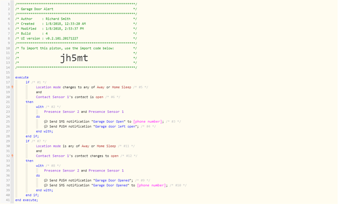

I am getting both alerts when the modes are away or home sleep when the garage door is opened. I need to figure out how to only send one of the alerts to our phones.
If the garage door is left open and we go away or the mode changes to “home sleep”, I want an alert that the door was left open. If the garage door is OPENED when we are away or mode is “home sleep” I want to get an alert that the garage door has been opened. I do not need both alerts to be pushed.
Currently, if we are in either of the modes listed in the piston and the garage door opens, we receive the alert that the garage door has opened AND that it is open. Can’t figure out a way to only send one notification.
I’m sure this is something very simple, but I can’t quite figure out how to get this functioning properly. Thanks in advance guys and gals!
