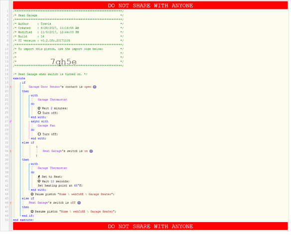

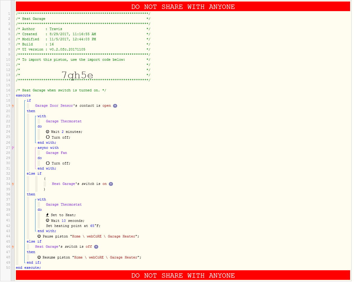

I’m obviously missing something. This worked in CoRe but will not work in WebCore.
You haven’t said what is not working so it’s hard to advise.

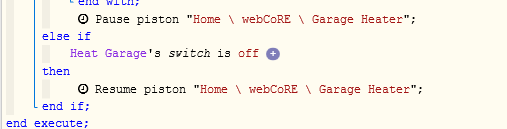

The only part that strikes me as stopping it from working is this bit.
Surely once you have paused the piston then there is no way it can resume because it will stop.
When the garage switch is off nothing will happen as the piston is paused.
Perhaps put that part in another piston and then get it to resume the first piston.
I’ve never paused a piston so this is purely conjecture on my part.
Nothing works on it. This piston is called “Heat Garage”. The one it is pausing is called “Garage Heater”. They are 2 different pistons. I’m pausing one that keeps the garage at a low temp and increasing the set point for when I want it warmer to work in there.
