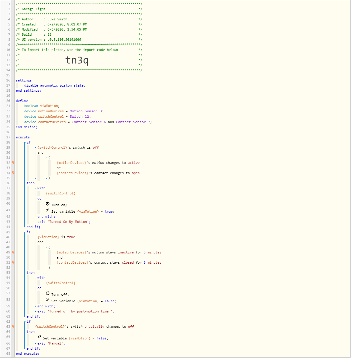

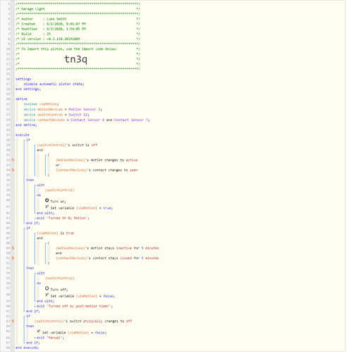

I have one piston that turns the garage light on if any door opens or there is motion. If the motion sensor is what turns the light on, it never turns off. If I hit the physical switch, turn the light on in the app, or any of the door sensors open, the light will turn off after X seconds like it should.
Garage light turns off if no motion for X seconds
Light will only turn off if it was not the motion sensor that turned the light on in the first place.
