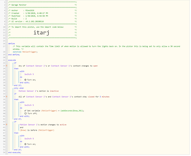

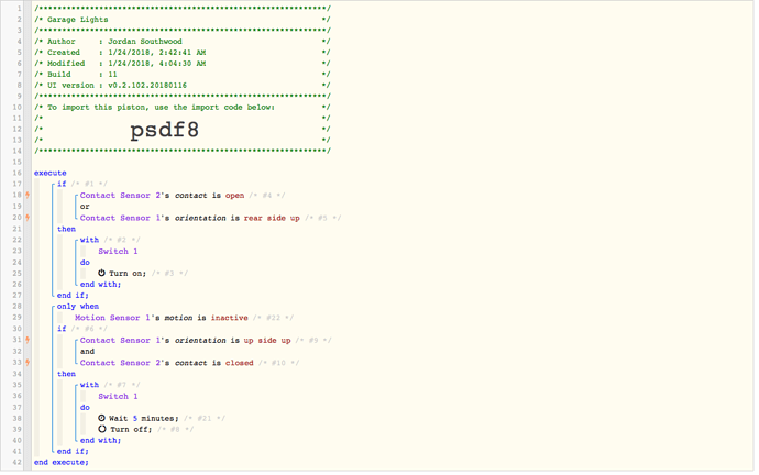

I have a smartthings multi sensor setup as a tilt sensor on my garage door. A contact sensor on my interior garage/laundry room door. A GE light switch controlling the garage lights and a GE motion sensor on my back wall in the garage.
Ultimately, I want the garage lights to turn on if either door opens. I want the lights to stay on if one or both of those doors is open. I want the lights to turn off in 5 minutes if both doors are closed but only if the motion sensor does not see motion, otherwise that means I’m in there working. The problem is that sometimes when I open the interior door to grab something or put something away it doesn’t always activate the motion sensor because of where it needs to be mounted (plus the response time is much slower than the door sensors). I don’t want the motion sensor to turn on the lights because the cold and warm drafts have a tendency to trigger motion sensor in a garage so I only want it to sense my presence once I’m there. (except maybe to turn the lights back on if they’ve only been shut off for under 30 seconds… say if I was sitting and reading something, etc… then I could just wave my hand and have them come back on).
I’ve tried building a number of pistons but there’s always some part not working right. Usually it is that the lights won’t turn off at some point… as is the case with this more basic piston I’m posting.
