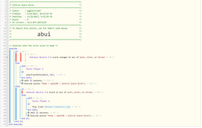

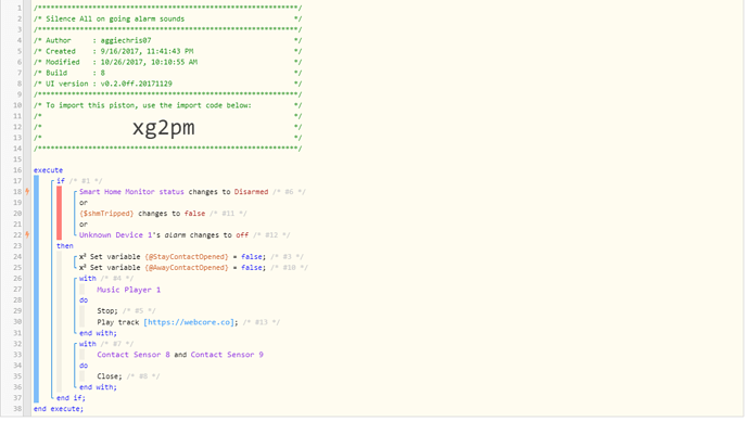

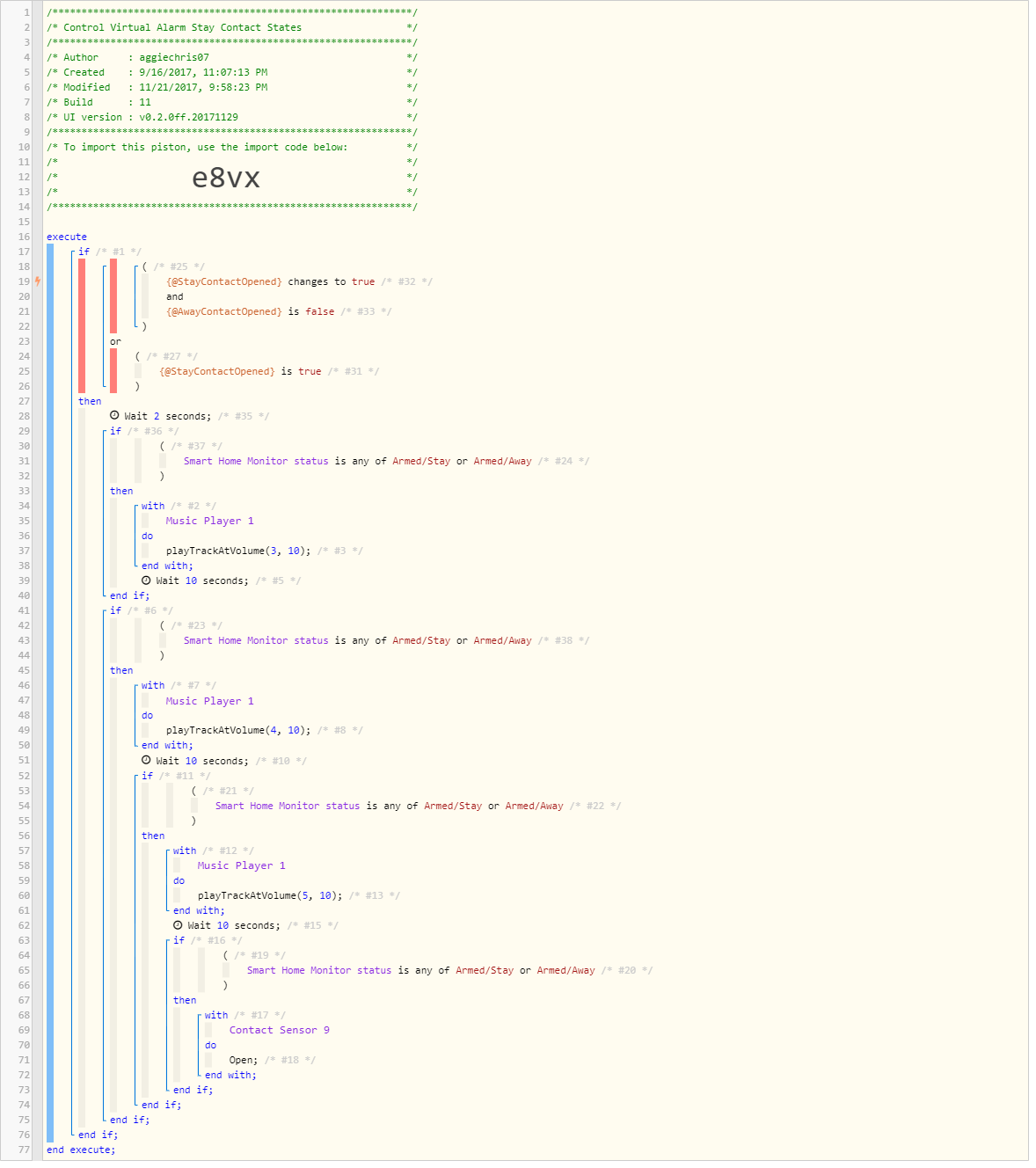

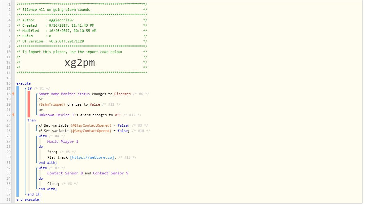

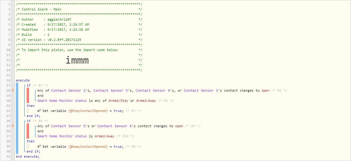

I am having issues with lots of delays and slow responses with Pistons, my guess is that my pistons are designed sub-optimally. I am looking for some advice for a way to speed up my piston response, especially some general guidelines.
Specific example:

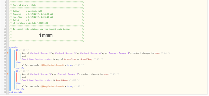

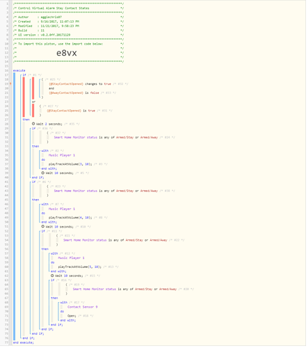

I have a set of pistons where I am trying to control a home made alarm system.
Basically, I have a couple of pistons that start warning tones when the alarm is active and one of the contacts open.

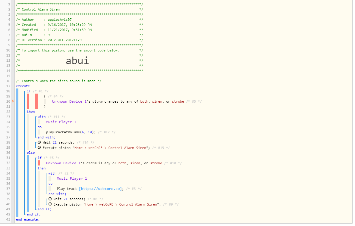

If it makes it through the warning time before being deactivated, smarthome monitor is activated, which activates another piston that controls the alarm sounds.
If during anytime, the system is disarmed another piston silences all ongoing sounds.

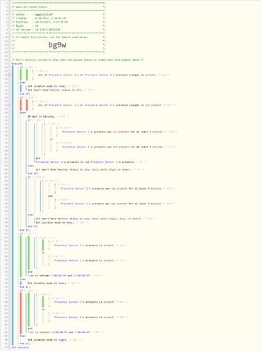

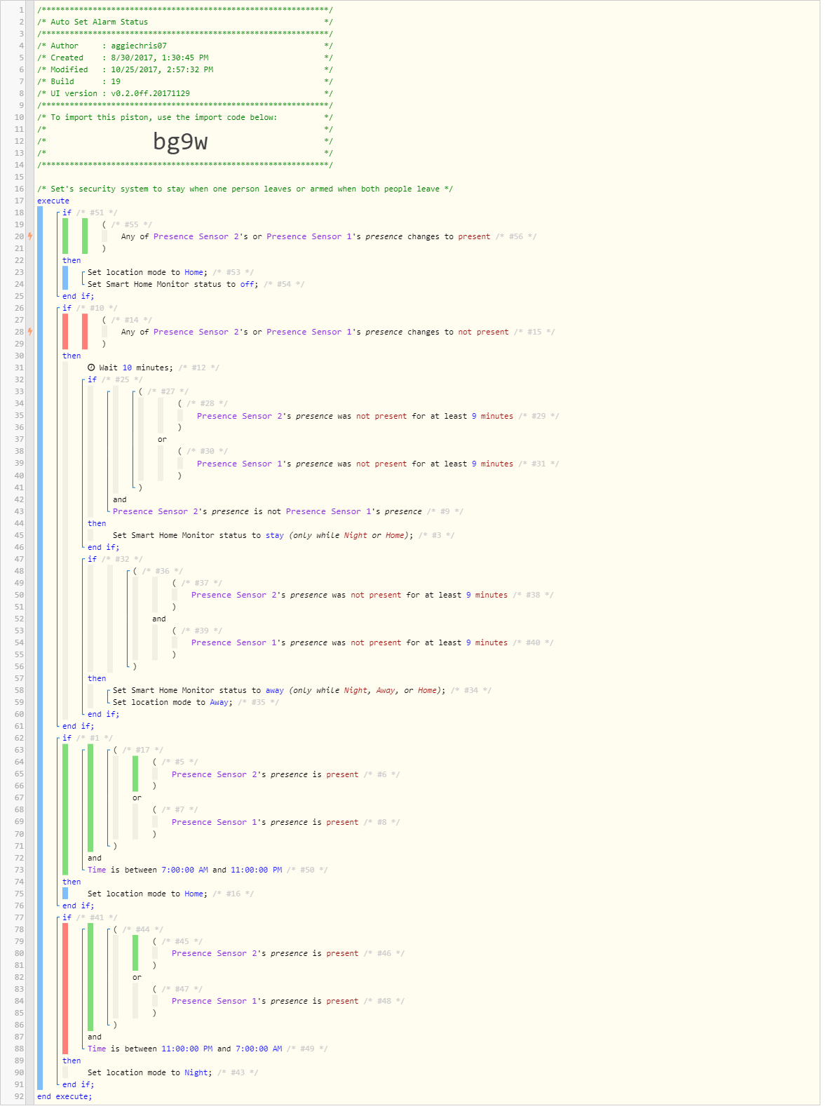

And finally, I have another piston that watches presence sensors, and sets smarthome alarm state to armed-home, armed-away, and disarmed based on precense senors.
Ultimately, I would really want everything to work fast enough that when I get home, things automatically disarm with any input from me. I am experimenting with the new webCore presence sensor, but in the mean time, I am looking for advice both general and specific to make things work faster/better.

I can only post three pictures right now, so here is my main alarm, warning, and alarm sound pistons.

Here are the automatic control, other warning, and silence alarm pistons
