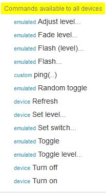

Yes. The top part of the drop down will change depending on which Device Handler is controlling that device. For example, when I select a boring white bulb, these are my only options:

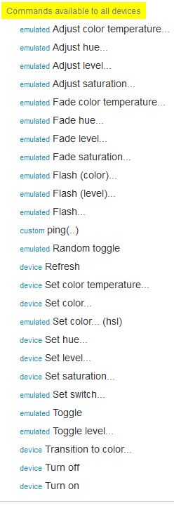

If I select a fancy RGB bulb instead, my choices are very different:
