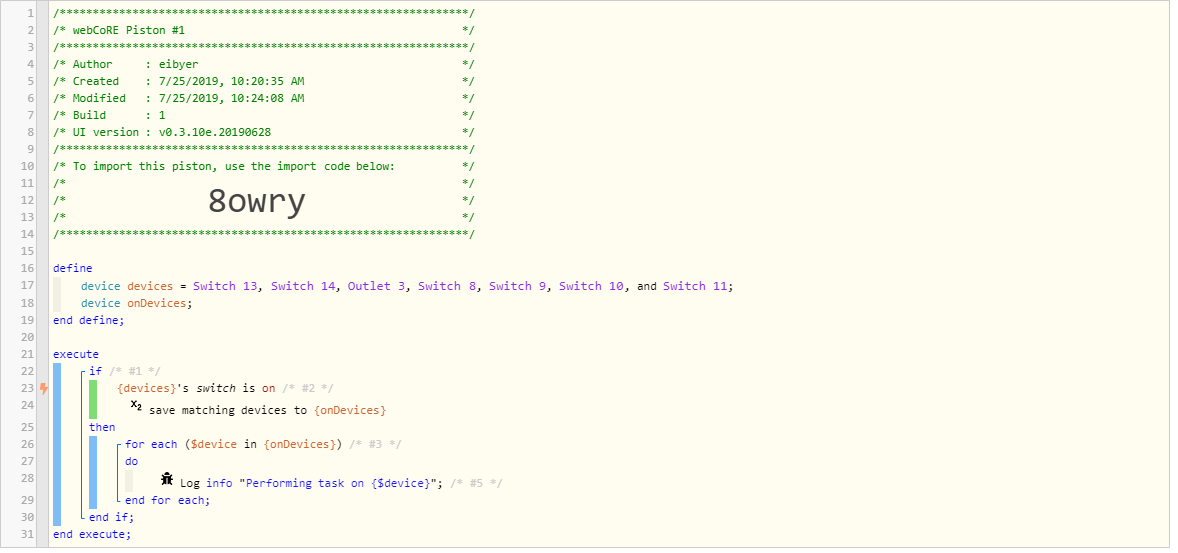

Is it possible to get the names of devices which are switched on, and then perform some action on these, for example change the dim level?
Yes, here’s a rough example…
Exactly what I was looking for, thank you very much!

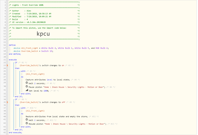

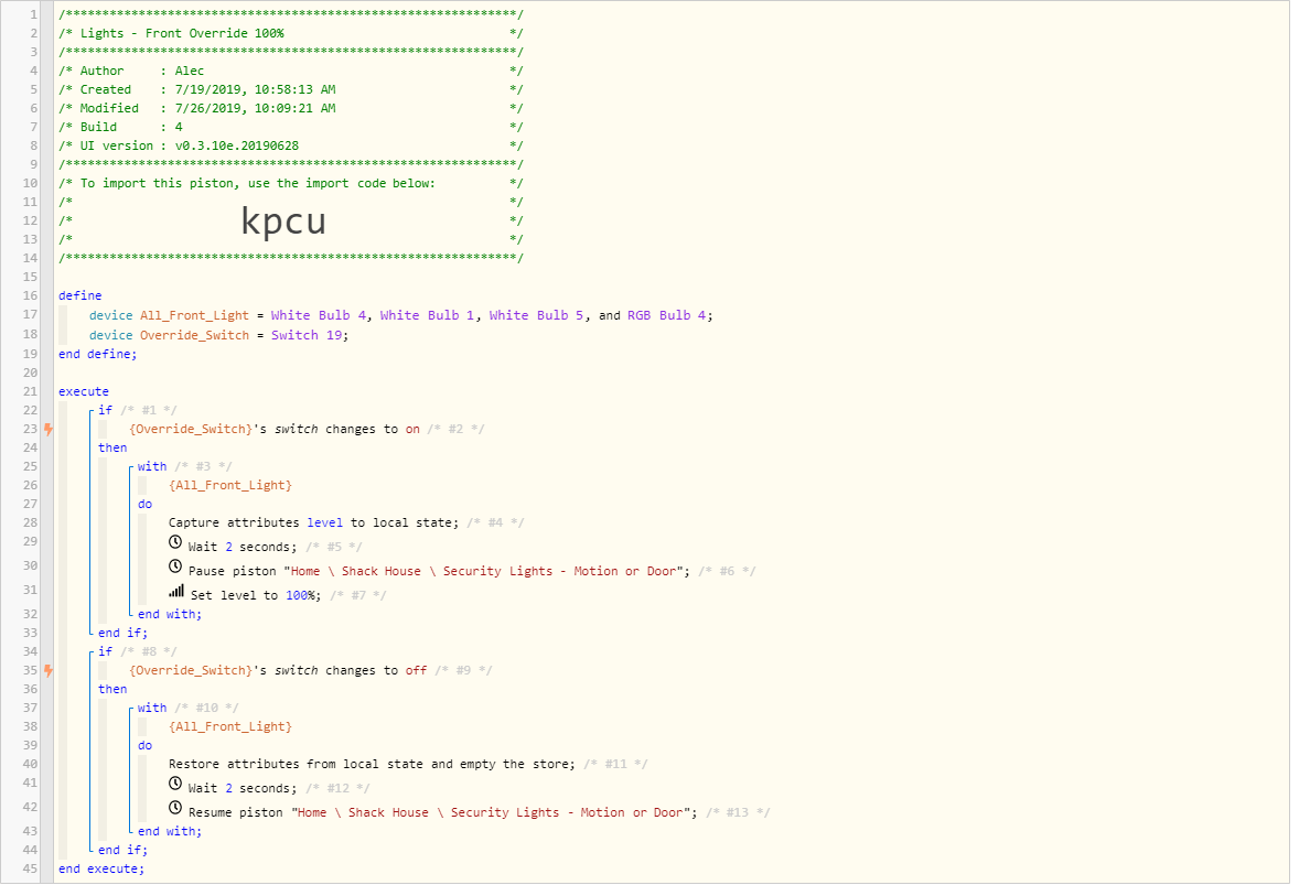

I have a piston like so, but not sure if this is the proper way to do it:
Hmm let me modify the one I posted above and see if it works. I’m not at home to play with lights at the moment :wink:

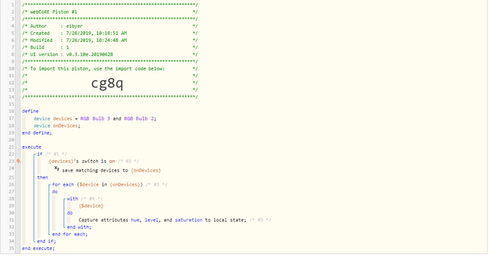

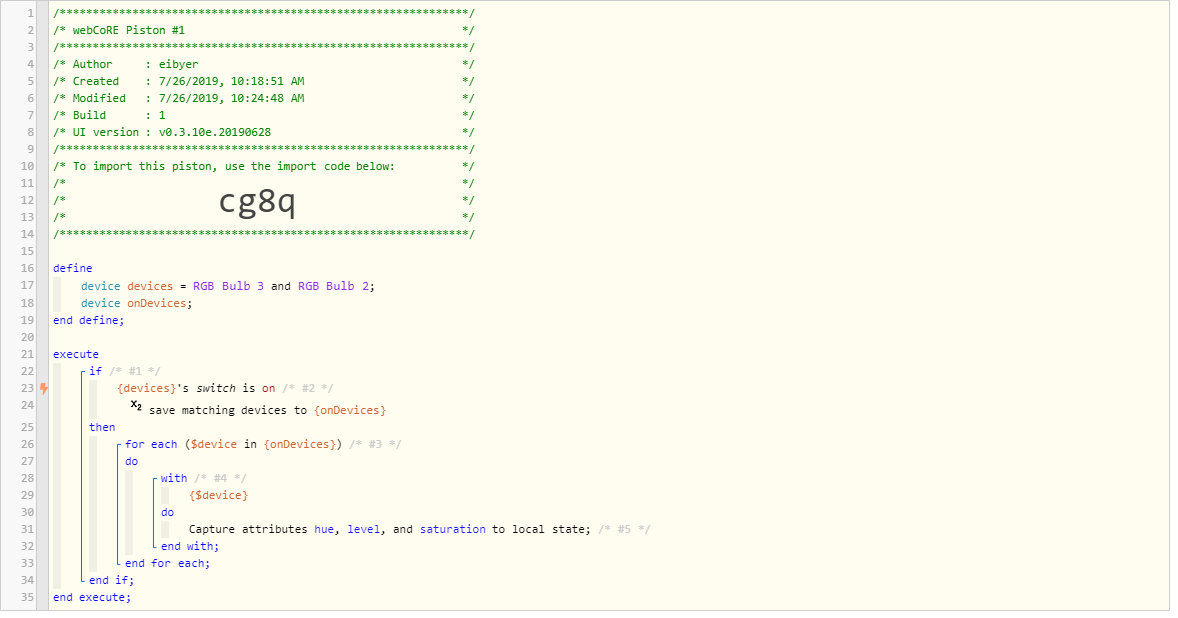

Edit:
I just changed the Log tas to Capture state… If you try this, you’ll have to add the Restore logic.
