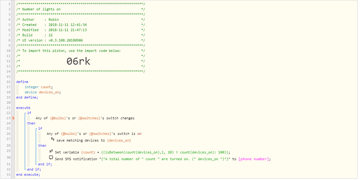

Now I understood what you meant! I tried
(isBetween(count(devices_on),1, 20) ? count(devices_on): “100”)
which I think is what you meant, right? If between 1 and 20; show the correct number. Else 100. In the expression output preview I get “100”, but when running it; nothing…

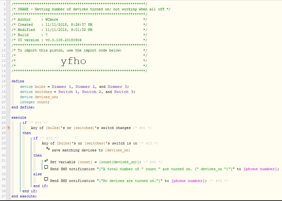

I made a slight modification to your piston. This works reliably when I tested it:
Lines 27-32 only happens if something is turned on…
If any device is on, it sends a detailed text… but if no devices are on, then the null count is irrelevant, because it sends the SMS located in the ELSE block.
One caveat, when you turn off the last device, it will not touch the two variables.
(so the old data will be remembered until a device turns on)
This is why I did not reference either variable in the ELSE block.
