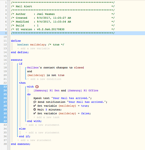

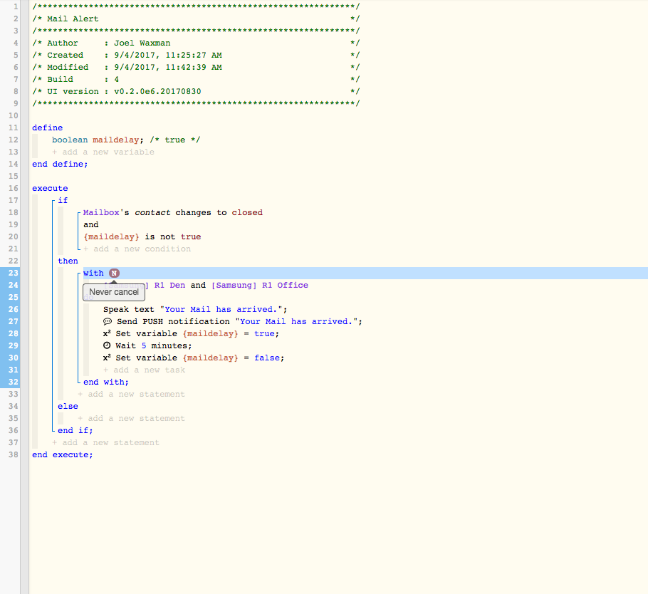

In edit mode, click on the WITH.
Scroll down and click on the cog.
Set TCP (Task Cancellation Policy) to never.
You may have to rename the variable now as it may be stuck on true.

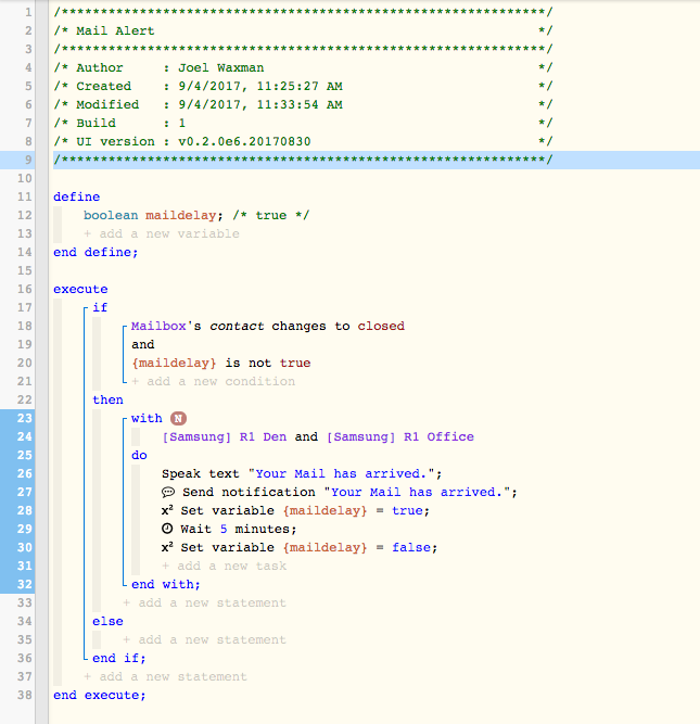

OK removed original, imported new one and changed Task Cancellation Policy as told. Also changed the variable. Thanks, I think it works. I am testing again.
Tested this one and it definitely works for me.

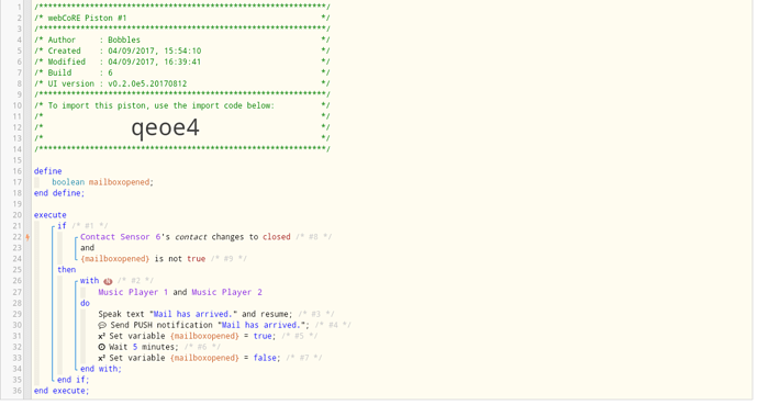

In your picture TCP is not set to never.

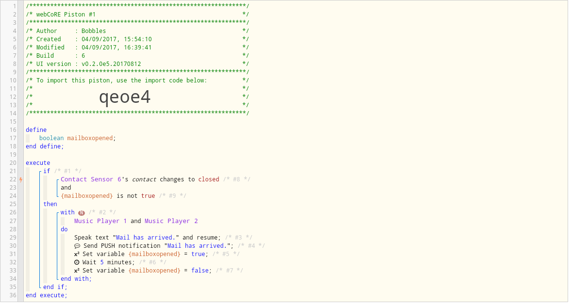

Try again by importing this and see if it works.
Btw I’m using Sonos speakers not Samsung.

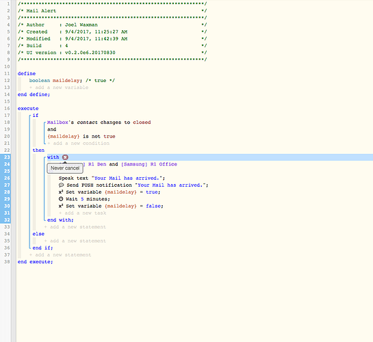

OK it worked once, then stopped. I am waiting five minutes as it might have been in the waiting time. I also changed “notification” to PUSH. Also it says TCP is never in screenshot.
Yes. I noticed I’d selected the wrong notification. Did change it on my amended version above.
