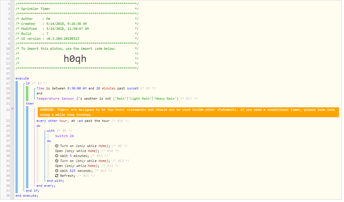

Warning in Piston
Start a timer with Conditions
Is this going to work with the warning?

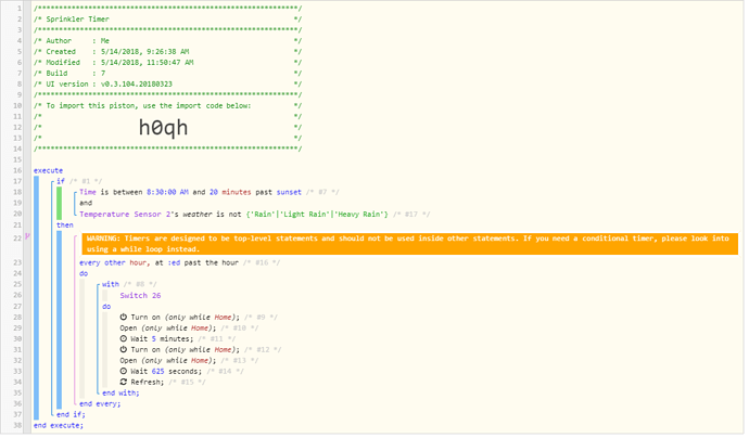

Warning in Piston
I would switch the two blocks around like this:
Every other hour at 30 past the hour
IF Time is between X and Y
and weather is not raining
Then DO with Switch 26
Turn on
Blah blah blah
