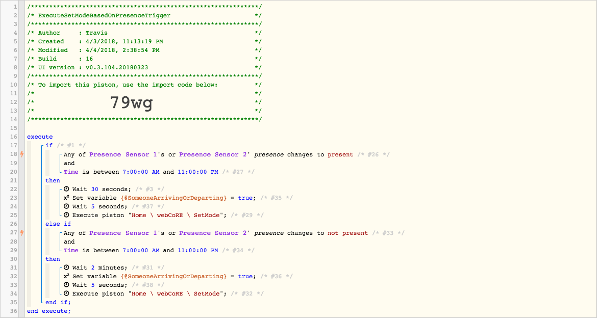

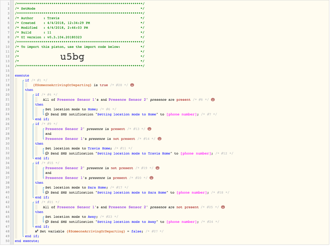

I am using a global variable as a flag. When I set the global variable and then immediately call the piston that is using it as a condition, the piston does not see the condition as the expected value unless a wait is introduced AFTER the global variable is set to a different value.
