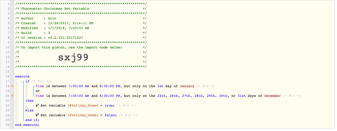

Variable isn’t turning true at 7:05am on January 1st.
Variable to change to true for both conditions.
The variable changed as expected for the week in December, but didn’t work for January 1st.
1/1/2018, 7:04:59 AM +150ms
+0ms ╔Received event [4 Keglovits Lane].time = 1514808300000 with a delay of -851ms
+138ms ║RunTime Analysis CS > 42ms > PS > 60ms > PE > 36ms > CE
+140ms ║Runtime (41273 bytes) successfully initialized in 60ms (v0.2.101.20171227) (139ms)
+141ms ║╔Execution stage started
+222ms ║║Comparison (time) 25499299 is_between (time) 25500000 .. (time) 73800000 = true (50ms)
+240ms ║║Time restriction check passed
+242ms ║║Cancelling condition #16's schedules...
+243ms ║║Condition #16 evaluated true (93ms)
+253ms ║║Cancelling statement #16's schedules...
+264ms ║║Requesting time schedule wake up at Mon, Jan 1 2018 @ 8:30:00 PM EST
+267ms ║║Cancelling condition #11's schedules...
+267ms ║║Condition group #11 evaluated true (state changed) (119ms)
+270ms ║║Cancelling statement #14's schedules...
+275ms ║║Executed virtual command setVariable (2ms)
+279ms ║║Fast executing schedules, waiting for 571ms to sync up
+933ms ║║Comparison (time) 25500012 is_between (time) 25500000 .. (time) 73800000 = true (48ms)
+947ms ║║Time restriction check passed
+949ms ║║Condition #16 evaluated true (87ms)
+950ms ║║Cancelling statement #16's schedules...
+957ms ║║Requesting time schedule wake up at Mon, Jan 1 2018 @ 8:30:00 PM EST
+960ms ║║Condition group #11 evaluated true (state did not change) (99ms)
+963ms ║║Cancelling statement #14's schedules...
+968ms ║║Executed virtual command setVariable (1ms)
+973ms ║╚Execution stage complete. (831ms)
+975ms ║Setting up scheduled job for Mon, Jan 1 2018 @ 8:30:00 PM EST (in 48299.876s), with 1 more job pending
+992ms ╚Event processed successfully (992ms)`
