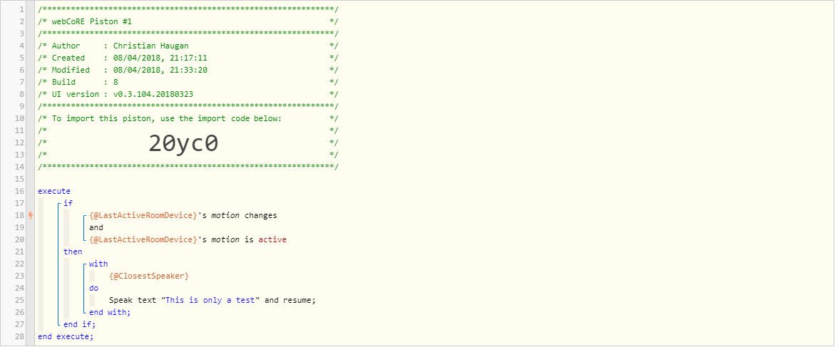

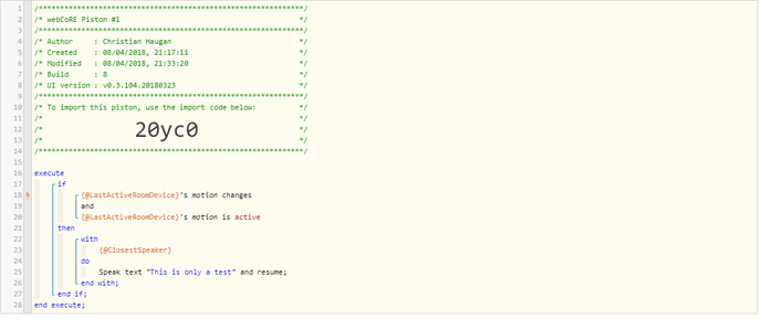

Do you know if it’s possible to subscribe to a global variable set by a master piston which sets the global variable to the current active room?
This is my piston which was suppose to subscribe to the current device set in the global variable, but when I save/start the shown piston, the piston only subscribes to the currently set device and does not respect if the device have switched based on the contents of the variable since it was started.
