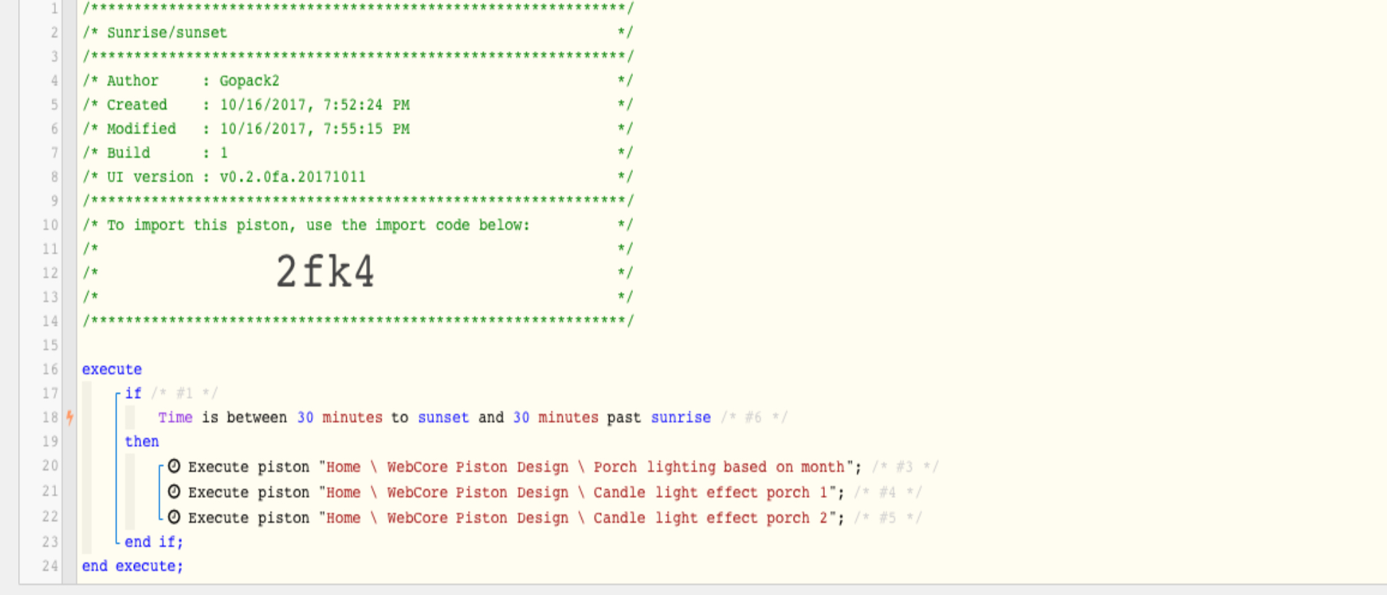

Try this.
This triggers at the time. And then calls the pistons. Create a separate piston for each

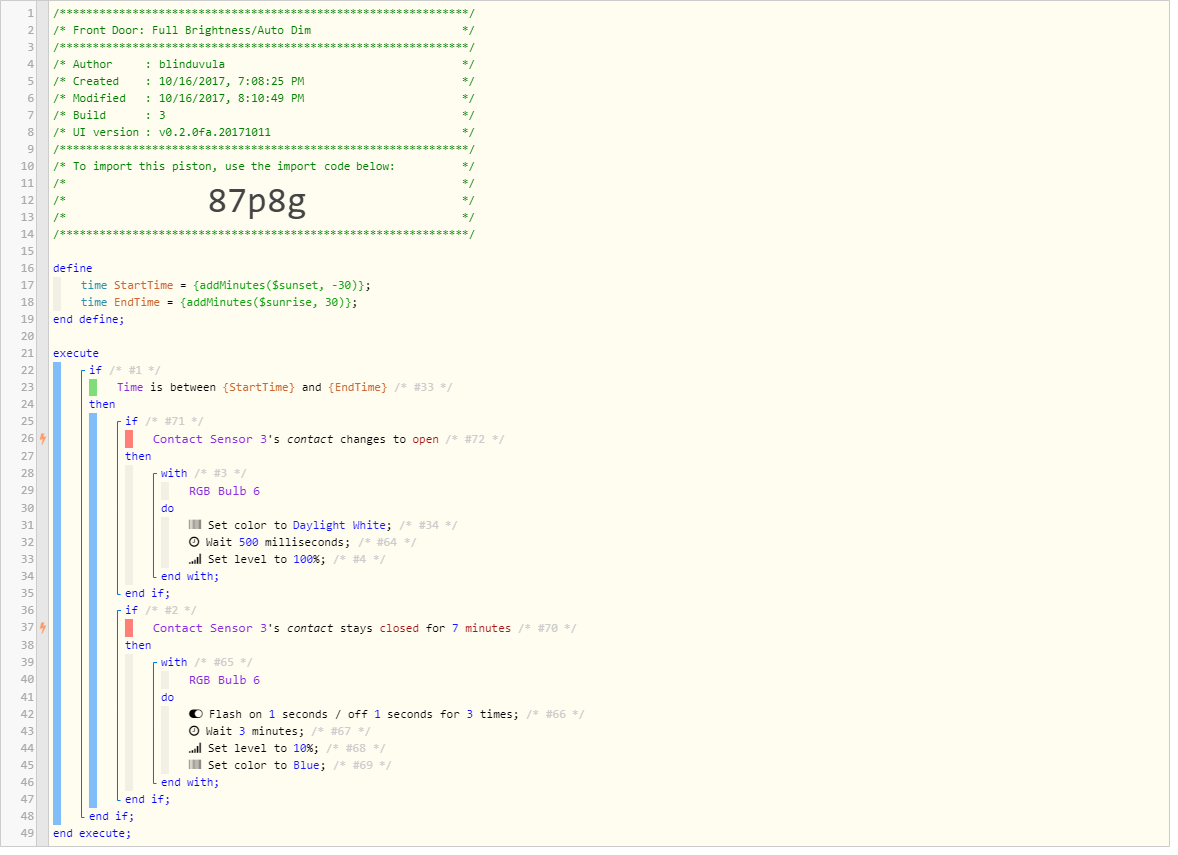

Maybe this will make more sense. Here is an example of one of my pistons. Instead of setting the same local variable in multiple pistons, I was trying to value one set of global variables to be used across all pistons, not necessarily to make them execute pistons.

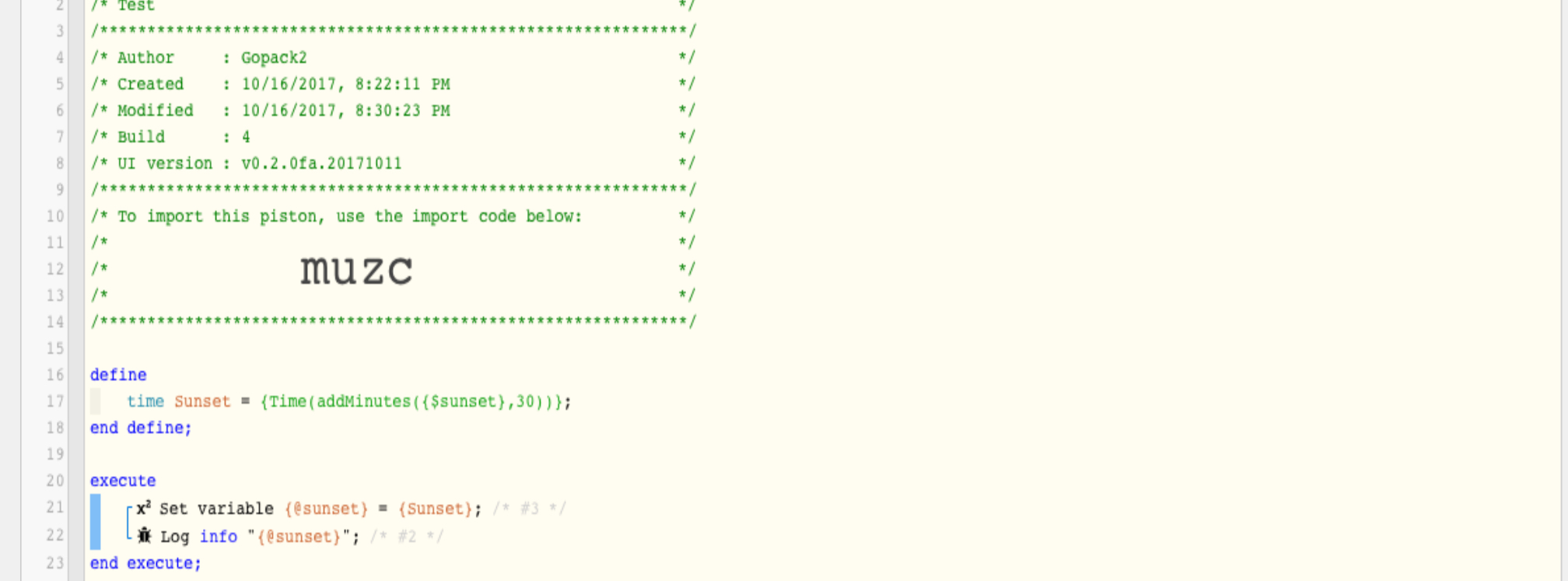

For whatever reason setting global sets to 6;00 pm. However this sets correctly. Give it a try

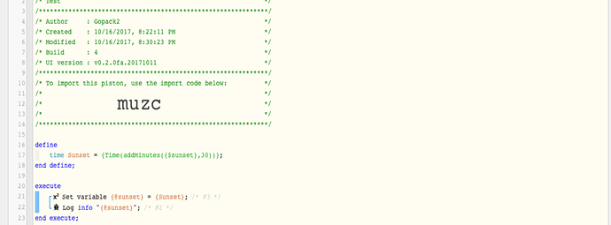

Nevermind that. Set your sunset like this
Set global variable = Time(addMinutes({$sunset},30))
You need to define that in a piston run though. It won’t set via expression directly to the global variable. For whatever reason
