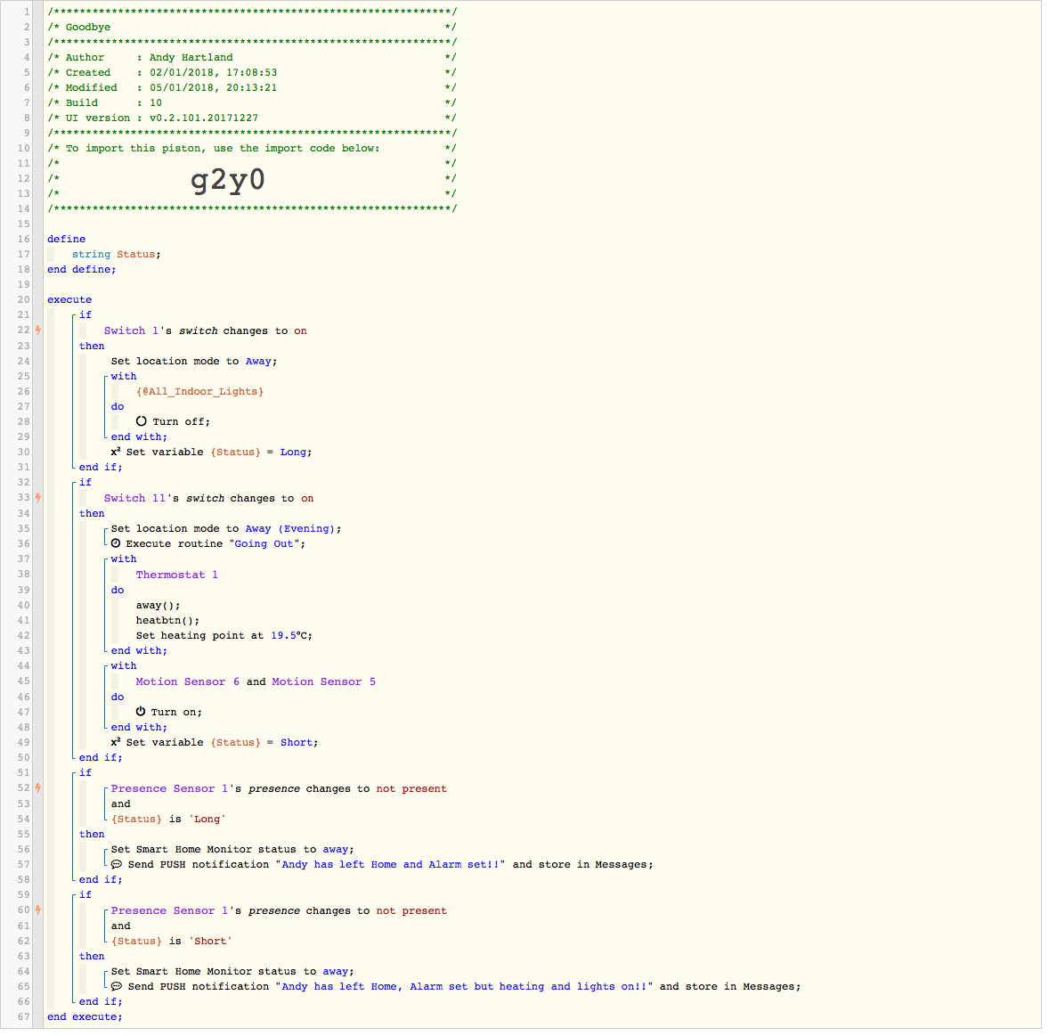

Going Out piston
Piston to replace Going Out routine as I want to have a delay in SHM coming on. This is to stop the alert that my front door is open as soon as I trigger the routine via my virtual switch on ActionTiles. Plus sometimes I need to go into the garage before I actually leave the property so I want the main actions like heating, lighting and cameras to function but not the SHM until I actually leave the location.
I also want to have a ‘popping out’ feature that allows me to go out for a shorter period where I don’t want the lights and heating to go off. Created the piston here and it seems to work but I want to know if the way I have achieved it is ideal or can be improved. Plus as I’m looking to have a Smart Yale lock fitted soon, if I should use one of the other triggers like ‘leaving place’ instead of ‘presence’ to set the SHM earlier,
As above, can it be made more efficient?
Seems to be working from my testing tonight but it takes a distance before the SHM gets triggered.
What do you think?

It looks pretty simple and efficient to me.
If you are concerned with it taking to long could just add a wait before setting the SHM instead of based on presence. But it kinda seems 6 one way and a half dozen the other.
Thanks, that’s good to know as I am aware I’m barely scratching the surface of WebCoRE so how I go about achieving the goal may not be the most efficient. I did use a time initially but as sometimes i’m leaving immediately and others I’m in the garage to get my bike ready, it wasn’t really working for me. So something that actually triggers after I left the property seemed best.
I like the idea of using wi-fi as a trigger to keep it nice and close to the property :smile: Will have a look into that, thanks.
