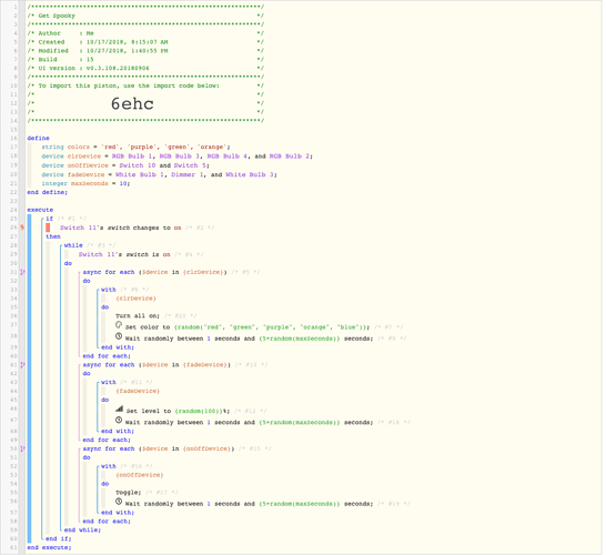

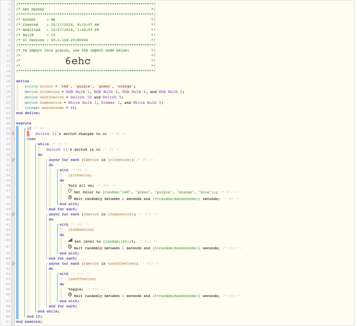

With Google Assistant’s “Get Spooky” feature not controlling lights this year, I tried to simulate the functionality in WebCore. Turn lights on/off, dim/brighten, and change colors. I’ve got the piston “working” but its behavior is not what I’m expecting.
Lights to randomly dim, turn on/off, change color.
Every thing starts off seemingly fine, but after a while it just seems to stop, but then seems to start up again. The lights that turn on/off don’t do so as often as I expect. I’m wondering If I just have too much going on and am running into a memory issue.
