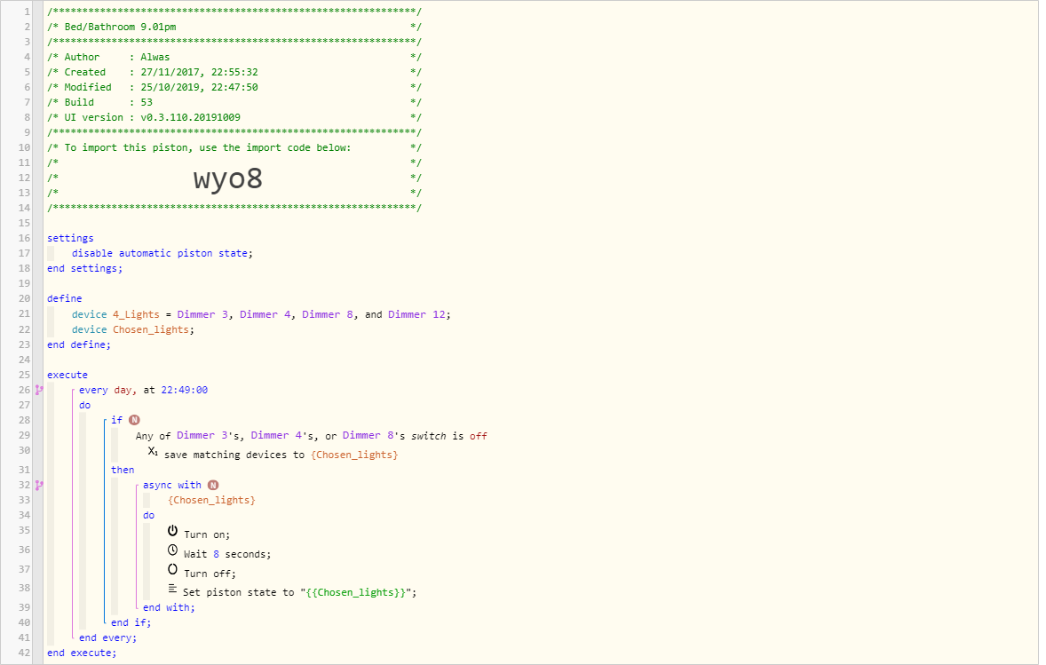

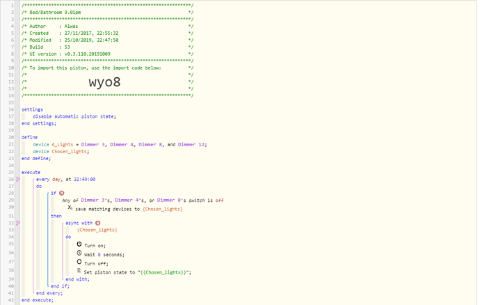

Group of lights not all turning off
So various lights don’t come on at full brightness at night, if they are off at 9pm they are saved to matching, then turned on for 8 seconds, then off. But more often than not, one of them will remain on!
I turned off TCP, tried Async, I’m sure I’m missing something obvious…
Edit, correct piston would help!
so I am rather confused at what it is you are trying to achieve .
Also; you say various lights, however you only have one light specified in this piston.

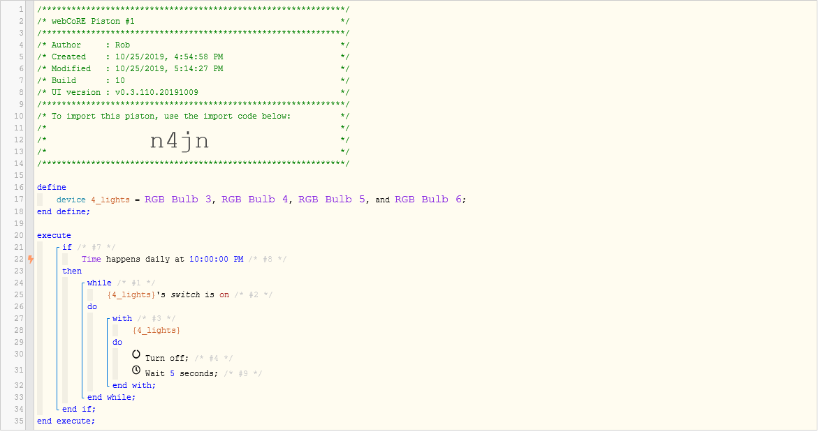

I’ve had similar issues with lights not going off. I suspect the command was sent, but the bulb never got it or something. What I usually do is create a while loop that essentially works as error checking. I don’t know what happens if the bulb never goes off, but this seems to work…
If I try to control too many devices at once, or a few devices happen to be a bit far from my hub (relying on mesh hops), or a DH is a bit sluggish, I may occasionally have to program this way:
IF X happens
Do Y
    Turn off bulbs
    Wait 2 seconds
    Turn off bulbs
END IF
I know, it’s a bit of a hack… but webCoRE is smart and will not send a “off” command to a device that is already off… So all is good.
