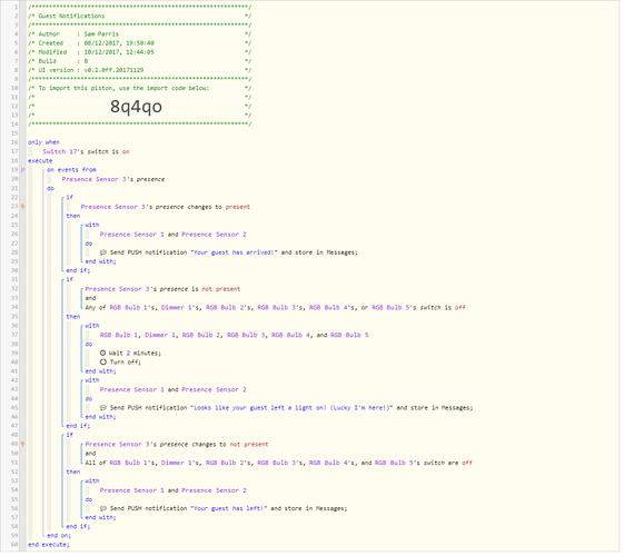

This piston should send notifications if our guest leaves or arrives, will this work even though it only subscribes to two events?
Either get rid of the on events portion or change the the two triggers to conditions. Instead of changes to it would be is/are
