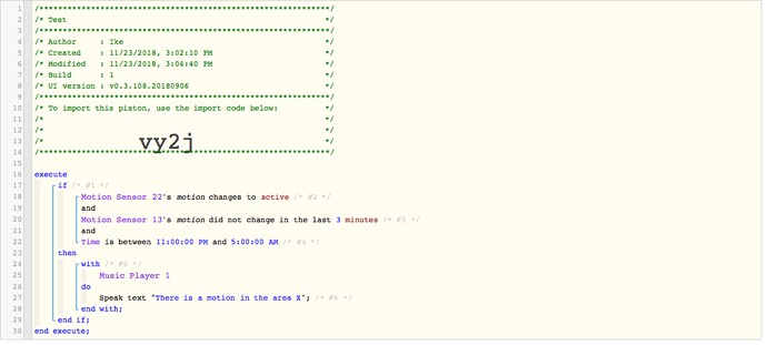

Can you post up a green snapshot of the piston you have working now? Should be a quick change to get it working the way you want.
Maybe somthing like this???
Did not test it but if I needed it, I would start with this.
in your case, motion sensor 22 would be the kitchen
and motion sensor 13 would be the bedroom
So, unless conditions are a match there will be no annoucment…
(On the paper:)))))

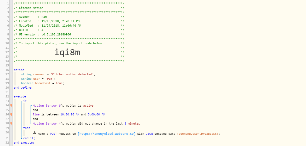

Here is my piston but it is not reporting every motion. I have used the similar approach suggested by @ike2018. It is reporting every other minute and changed my time for testing purpose.
I would change your motion IS active to Motion changes to Active, like in the example. Then that will be the trigger and the others will be conditions.
Thanks for the feedback… I have changed them to motion changes to active.
