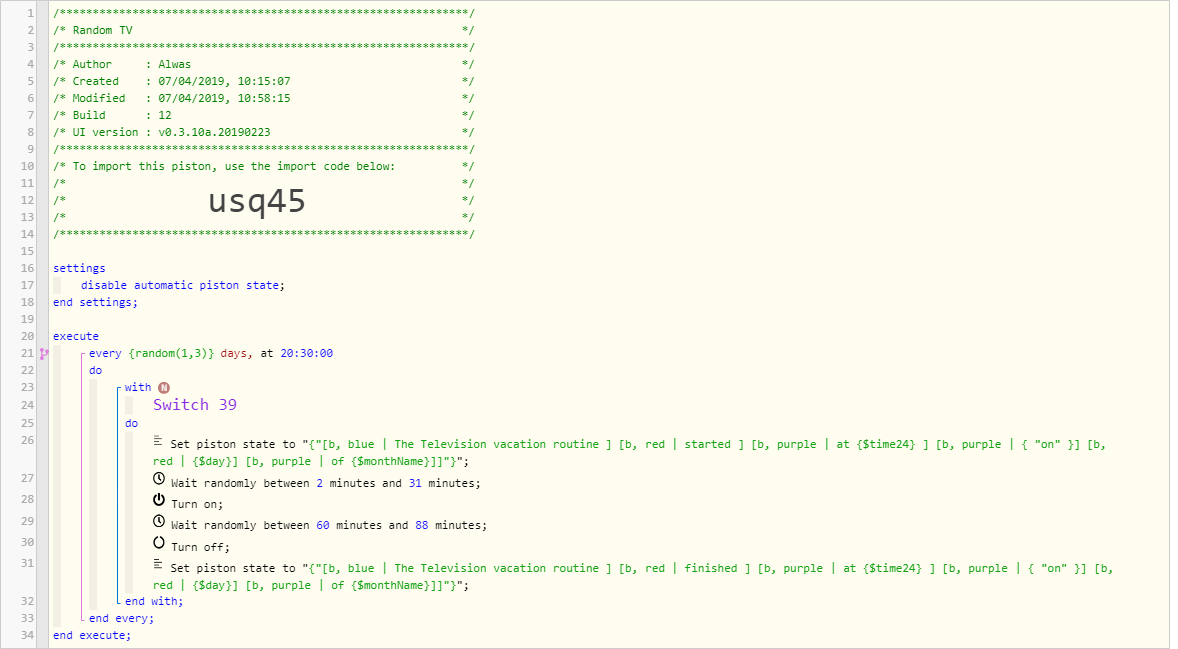

As the title says, I’m trying to turn on a switch randomly two or three times a week, on randomly changing days.
I see “Happens daily at…”
If someone has an idea I’d be grateful, it will probably involve an expression I’m guessing.
"Happens on 2/3 random days of the week..."

I can’t picture how a trigger of random 35% every day at noon would look, although it looks like it could help me.
Specifically I’m trying to do a vacation piston for my tv.
So every random 2 or 3 days of a week,
At a random time between 8pm and 9pm
Turn tv on, for a random time between 1 hour and 1.5 hours.

Seems like you could fire every night at 8, generate a random number 1-3, then only if it is 1, then you do a random wait, turn on, random wait, turn off something like this:
Every day at 8 pm
Do
Set irun = random(1,3)
End every
If irun is 1 then
Wait random(60) minutes
Turn on
Wait random(60,90) minutes
Turn off
End if
