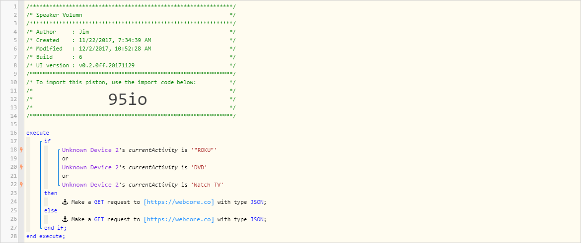

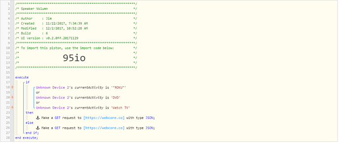

Trying to detect the activity of a Harmony unit
When I turn my Harmony on, ie select activity, I want to detect that an activity started.
It doesn’t seem to detect that an activity has started.
+0ms ╔Received event [Home].execute = 72.161.53.28 with a delay of 92ms +106ms ║RunTime Analysis CS > 15ms > PS > 28ms > PE > 64ms > CE +116ms ║Runtime (38982 bytes) successfully initialized in 28ms (v0.2.0ff.20171129) (115ms) +117ms ║╔Execution stage started +132ms ║║Comparison (string) Watch Roku is (string) "ROKU" = false (2ms) +133ms ║║Condition #6 evaluated false (10ms) +141ms ║║Comparison (string) Watch Roku is (string) DVD = false (2ms) +143ms ║║Condition #7 evaluated false (8ms) +150ms ║║Comparison (string) Watch Roku is (string) Watch TV = false (1ms) +152ms ║║Condition #8 evaluated false (9ms) +153ms ║║Condition group #1 evaluated false (state did not change) (29ms) +155ms ║║Cancelling statement #11's schedules... +162ms ║║Sending internal web request to: 192.168.1.105:55001/UIC?cmd=%3Cname%3ESetVolume%3C/name%3E%3Cp%20type=%22dec%22%20name=%22Volume%22%20val=%2212%22/%3E
