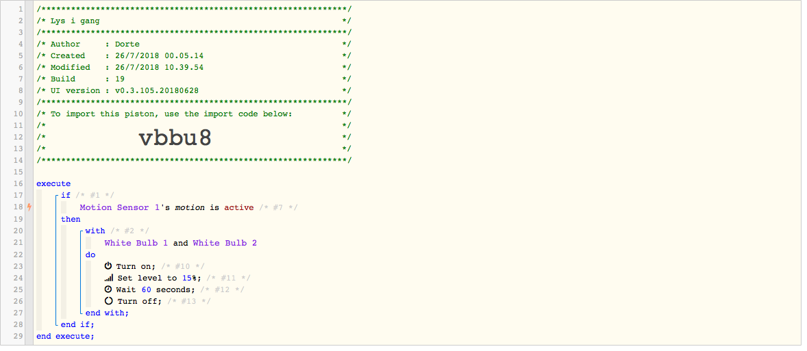

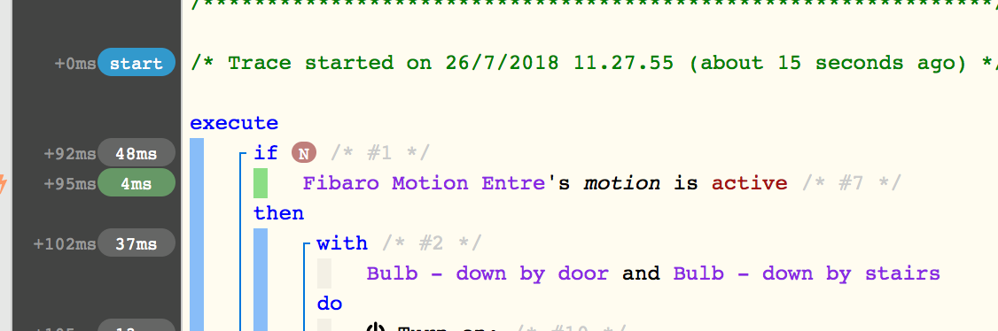

Timer ends at change in event on motion sensor
The timer should not end
Prevents the tast to complet after wait
By some strange reason it kills the timer when motion sensor sends (no motion)
Did try out different Device handler, and tried different options on behaviour on the IF.
Anyone seen this before?
Have numbers of pistons working fine, but this is on a friends system.
