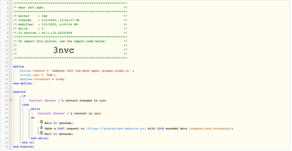

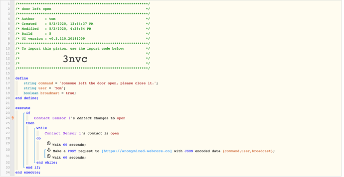

Like this? I think i might have the first wait incorrectly placed?
The first announcement goes off after 60 seconds. However, a second announcement does not play 60 seconds later while the door is still open. What do you think the prob is?

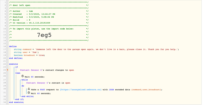

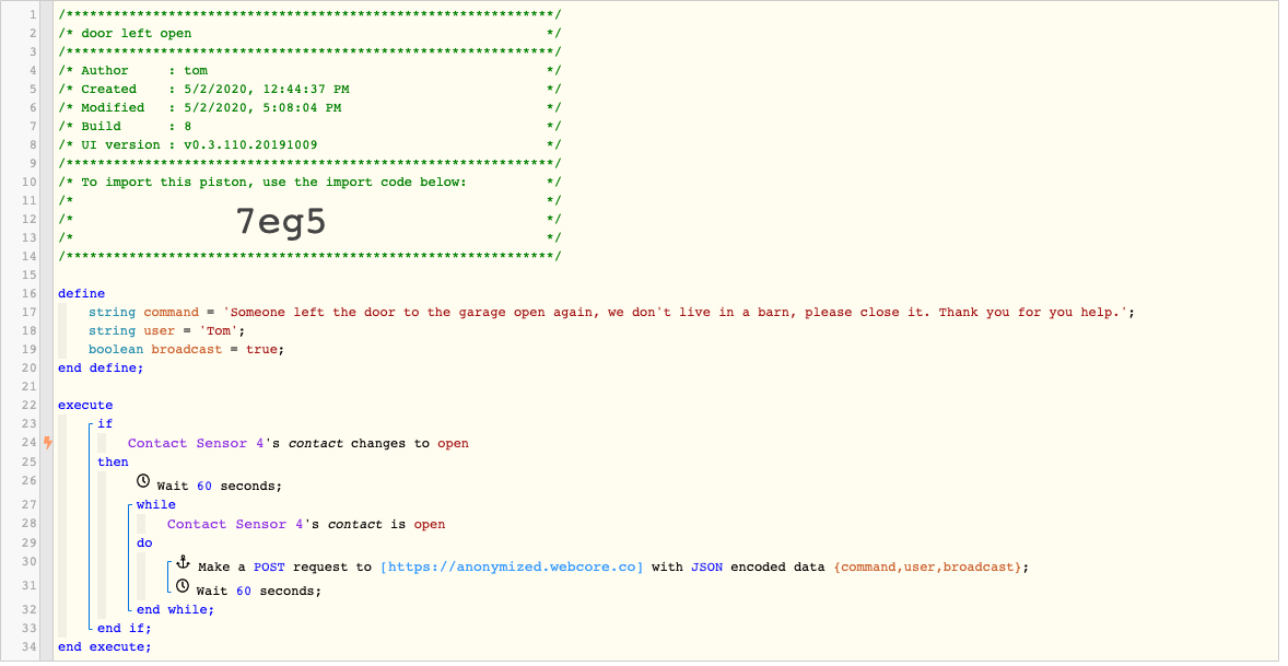

I think I have it now. Thanks!
You might want to delete the second WAIT on line 31…
(unless you want a 2 min wait between events)
