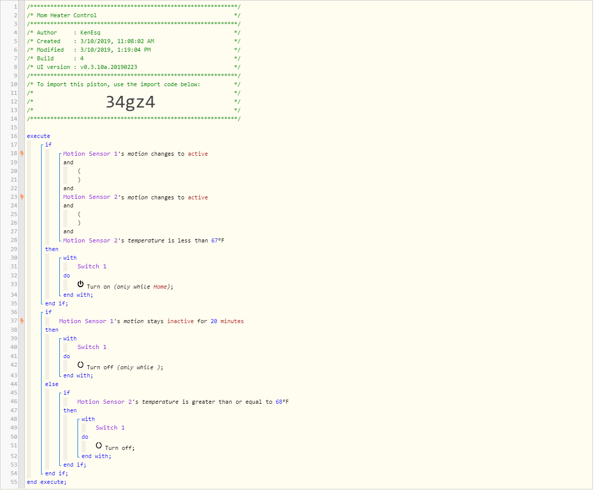

I’m trying to create a piston that will turn on a space heater by turning on a smart outlet when the following conditions exist:
  1. The two motion sensors in the room are active. (Mom & KWS Motion)
  2. The temperature (Mom) is below 67F.
  3. It goes off when temp is above 67 or person isn’t in room or no one is home (Away).
What have I missed or messed up?
Motion in room + Temp =<67 then On
No Motion for 20 Minutes = Off
Temp in Room =>68 then Off
Away Mode = Off
(PUT YOUR INFO HERE)

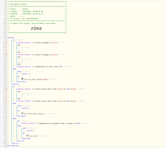

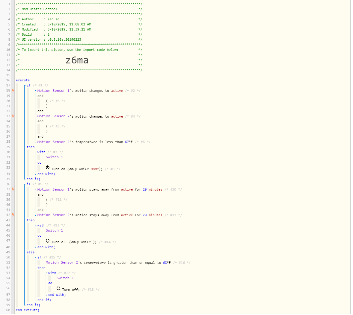

I think I had some logic errors and rewrote it to be this:
Two triggers in the same IF block is going to create problems… (two motion sensors change at the same time)
Most likely it will not execute…or will rarely execute.
What is the reason you want two motion sensors being active at the same time?
If you are trying to figure out the walking path (if they are just passing by or walking into the room lets say) pick the first motion sensor that gets activated, use that as a condition.
ie : Motion sensor A is in the hall way and motion sensor B is in the room.
IF motion sensor B changes to active (trigger)
AND
IF motion sensor A IS active (condition)
then do this do that..
But remember, if the person is slow or changes their mind and walks back, and comes back this may create problems.
In that case, if you insist on using two motion sensors as a trigger and/or condition, you can use variables to replace one of the motion sensors.
Thank you, I could use one. I used both to differentiate between someone coming in to grab something and someone actually sitting at the desk. The Mom detector is actually an Ecobee Sensor.
I’ll drop that one and see how it works.
Thank you.

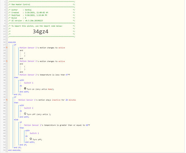

You reposted the same piston.
