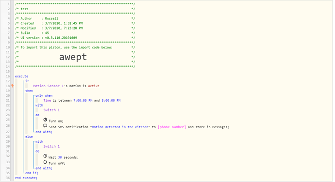

I’m having a problem getting my motion sensor to trigger a light switch when I only specific the “Time” range Restriction. When I specify both a “Date and Time” range Restriction it works as expected for that time frame.
The piston should make the motion sensor trigger the light switch to turn on the light between the time of “7:00:00 PM” and “8:00:00 PM”
The piston does not work in having motion sensor turn on the light switch. Instead the light switch does not turn on. However, the piston does run successfully in having the motion sensor detect motion and turn on the light switch if I modify the Restriction to be both Date and Time …Between: 3/7/2020 7:00PM and 3/7/2020 8:00PM. Also, I see weird behavior if I attempt to specify the action light turning on to occur on only one Day of Week (i.e. Saturday). I won’t confuse that scenario with what I mentioned above but fyi - such a change only functions if I specify a large time range such as 2PM to 7PM even when it’s after 7PM.

Here is how I would do this:
IF Sensor's motion changes to active          <-- Trigger
    IF $hour24 equals 19                      <-- Condition
        Turn on Switch 1
        Send SMS
    END IF
END IF
IF Sensor's motion stays inactive for 30 sec  <-- Trigger
    Turn off Switch 1
END IF
Notice I changed “ONLY WHEN” into an “IF”, and changed your condition into a trigger…
(and I used $hour24, which is a system variable)
This method will only turn on the light between 7pm and 7:59pm…
(the turn off works 24/7 with the current wording)

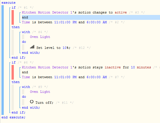

I add the time restriction as a Condition. It’s never failed this way.
Here’s an example: Night light in kitchen at night (oven light is the bulb above the stove)
The trace is RED right now, because it’s not within the time restriction.
