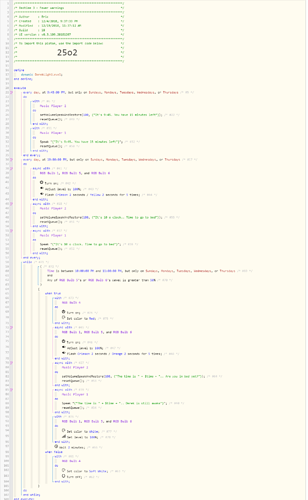

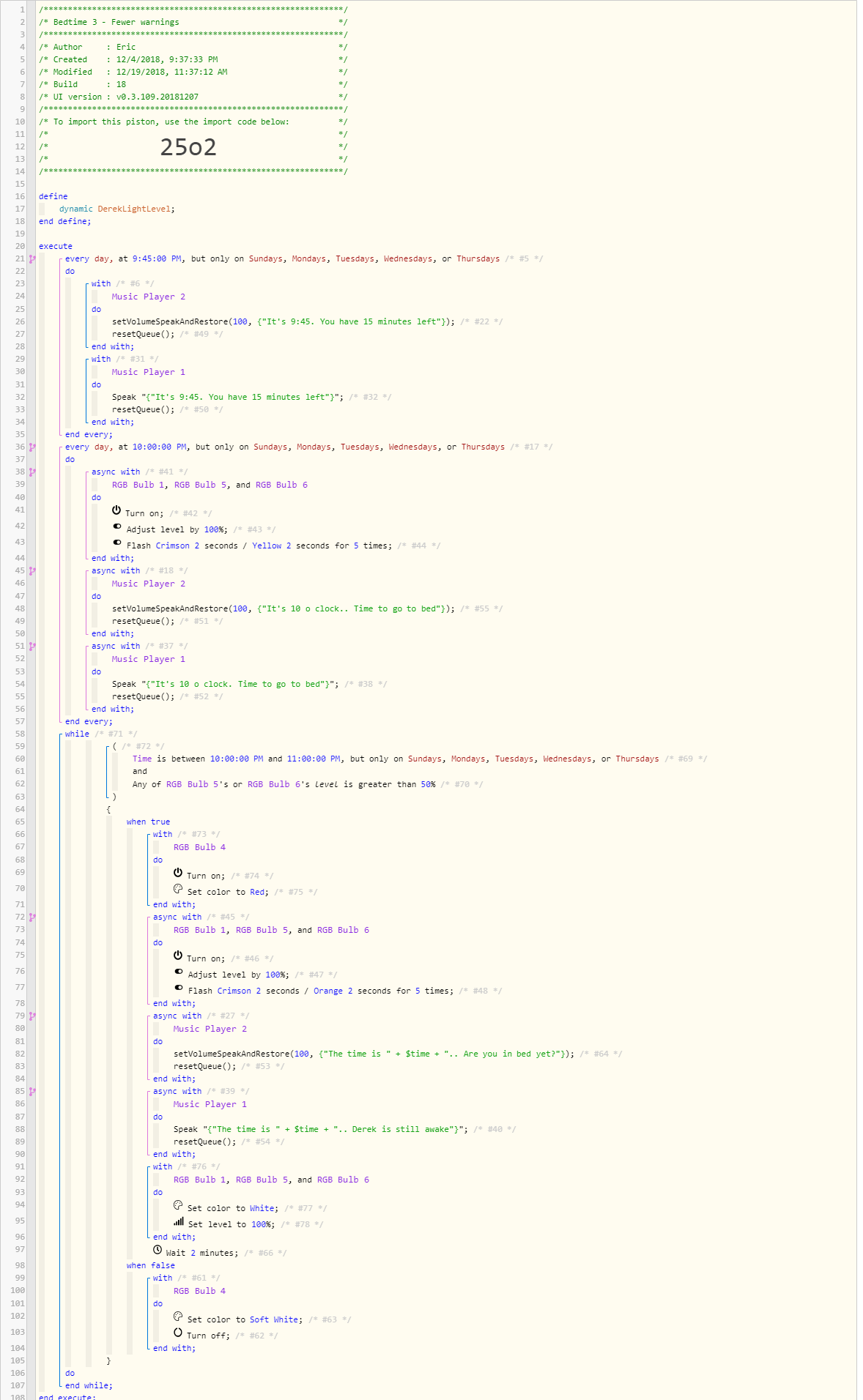

I have a piston that reminds my son about bedtime. The parts that notify him at certain times work, but my new loop keeps repeating immediately instead of waiting.
Time notifications, and then check light status on a loop until he turns down his lights for bedtime.
The lights change, but the spoken notification repeats over itself instead of waiting 2 minutes. It also doesn’t run unless I press the TEST button.
(I changed the time setting to current so it would run)

+1493ms ║Comparison (time) 42087265 is_between (time) 42000000 … (time) 42600000 = true (17ms)
+1496ms ║Time restriction check passed
+1499ms ║Cancelling condition #69’s schedules…
+1522ms ║Comparison (integer) 100 is_greater_than (integer) 50 = true (2ms)
+1524ms ║Cancelling condition #72’s schedules…
+1555ms ║Cancelling condition #71’s schedules…
+1570ms ║Setting up scheduled job for Wed, Dec 19 2018 @ 9:45:00 PM PST (in 36212.639s), with 1 more job pending
+1584ms ╚Piston successfully started (1583ms)
