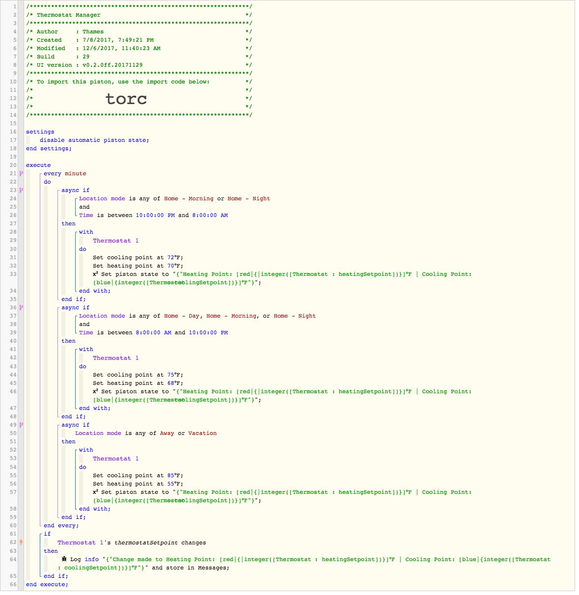

I have a Honeywell Lyric thermostat and a piston to manage it, but for some reason the heat does not come on when the temp is below it’s heating point. However it does work correctly for cooling.
When the temp drops below the heating point set for the given time period, I’d like the heater to come on.
The heater fails to come on and is frequently below the heating point set.
- Logs
12/6/2017, 11:41:24 AM +341ms
+1ms ╔Received event [Home].time = 1512589285035 with a delay of -694ms
+415ms ║RunTime Analysis CS > 18ms > PS > 61ms > PE > 335ms > CE
+433ms ║Runtime (47928 bytes) successfully initialized in 61ms (v0.2.0fe.20171109) (430ms)
+434ms ║╔Execution stage started
+457ms ║║Comparison (string) :dcfc45e435756029effce77ba8466bd3: is_any_of (string) :dcfc45e435756029effce77ba8466bd3:,:9a4e047fa524f4d97ad857190529c82e: = true (4ms)
+460ms ║║Condition #24 evaluated true (13ms)
+478ms ║║Comparison (time) 42084802 is_between (time) 79200000 … (time) 28800000 = false (14ms)
+480ms ║║Condition #26 evaluated false (20ms)
+481ms ║║Condition group #1 evaluated false (state did not change) (35ms)
+491ms ║║Comparison (string) :dcfc45e435756029effce77ba8466bd3: is_any_of (string) :988dab64f04e733662608bfbbd87c25c:,:dcfc45e435756029effce77ba8466bd3:,:9a4e047fa524f4d97ad857190529c82e: = true (4ms)
+493ms ║║Condition #7 evaluated true (8ms)
+510ms ║║Comparison (time) 42084835 is_between (time) 28800000 … (time) 79200000 = true (12ms)
+513ms ║║Time restriction check passed
+516ms ║║Condition #27 evaluated true (21ms)
+517ms ║║Condition group #37 evaluated true (state did not change) (33ms)
+521ms ║║Cancelling statement #4’s schedules…
+2175ms ║║Executed physical command [Thermostat].setCoolingSetpoint([75.0]) (1646ms)
+2177ms ║║Executed [Thermostat].setCoolingSetpoint (1649ms)
+3378ms ║║Executed physical command [Thermostat].setHeatingSetpoint([68.0]) (1197ms)
+3380ms ║║Executed [Thermostat].setHeatingSetpoint (1199ms)
+3394ms ║║Calculating (integer) 0 | (integer) 68 >> (integer) 68
+3405ms ║║Calculating (string) Heating Point: + (string) 68 >> (string) Heating Point: 68
+3409ms ║║Calculating (string) Heating Point: 68 + (string) °F | Cooling Point: >> (string) Heating Point: 68°F | Cooling Point:
+3412ms ║║Calculating (string) Heating Point: 68°F | Cooling Point: + (string) 75 >> (string) Heating Point: 68°F | Cooling Point: 75
+3415ms ║║Calculating (string) Heating Point: 68°F | Cooling Point: 75 + (string) °F >> (string) Heating Point: 68°F | Cooling Point: 75°F
+3418ms ║║Executed virtual command [Thermostat].setState (0ms)
+3428ms ║║Comparison (string) :dcfc45e435756029effce77ba8466bd3: is_any_of (string) :c99bffdf9a8b20cba73ceddcc7201c29:,:b79e052a61d75b56b6a15167838bfa62: = false (3ms)
+3430ms ║║Condition #17 evaluated false (7ms)
+3431ms ║║Condition group #38 evaluated false (state did not change) (9ms)
+3435ms ║╚Execution stage complete. (3001ms)
+3436ms ║Setting up scheduled job for Wed, Dec 6 2017 @ 11:42:25 AM PST (in 57.258s)
+3458ms ╚Event processed successfully (3458ms)
