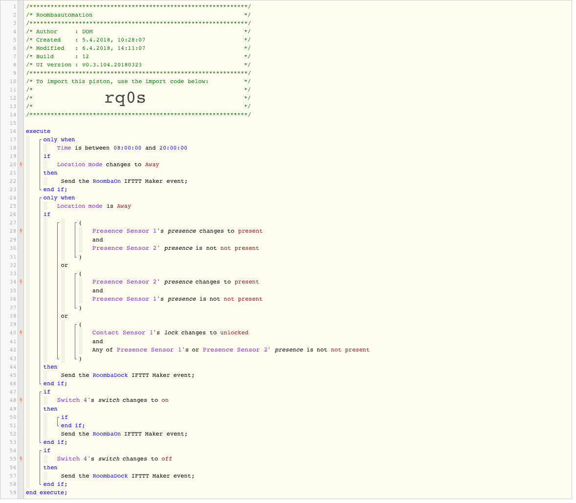

I have my Roomba connected to ST via IFTTT - works a treat. When the Housemode goes to “away” it triggers both a simulated switch for actiontiles and manual access aswell as the webhook to start roomba.

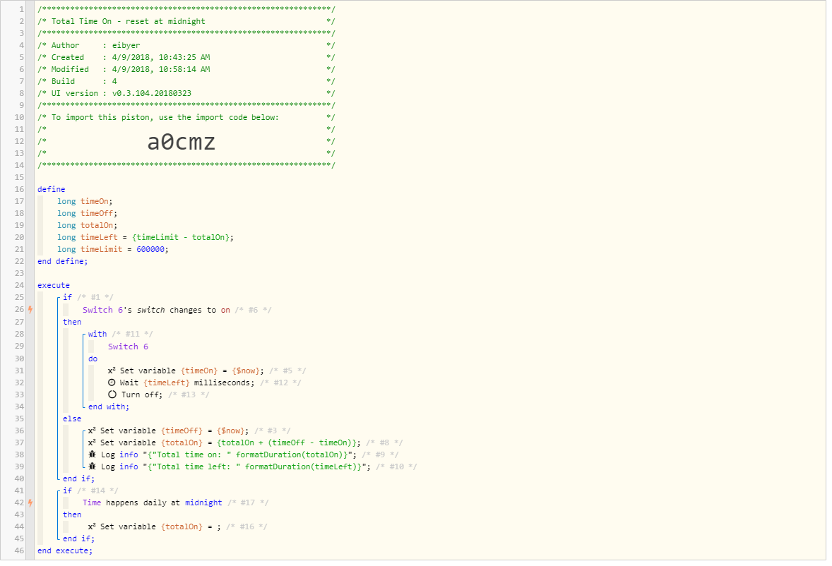

I do not know how to improve that piston by adding some kind of a daily counter that sums up all roomba-minutes resulting from several short “aways” and not start anptjer roomba journey once that total has been reached.
Sum up daily roomba-minutes and NOT start another cleaning cycle once one full hour is reached
