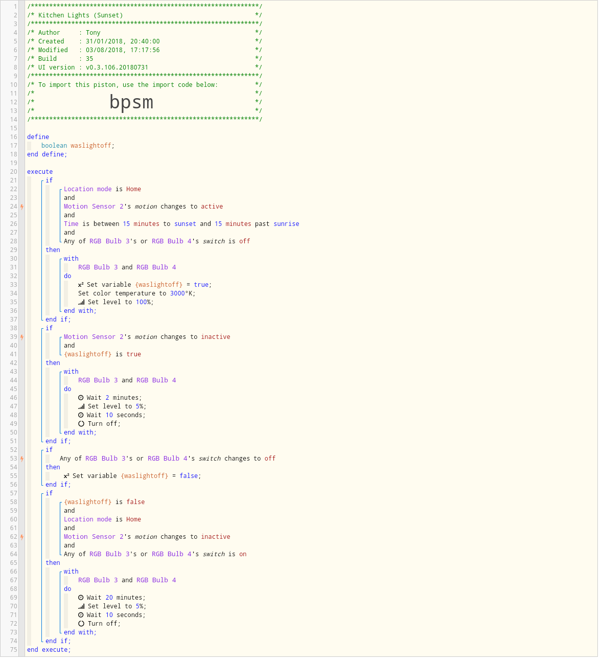

Sorry my screenshot shouldn’t have included the 2nd if statement as that isn’t going to work. This one kind of works but the lights don’t go back to 100 after dimming:
Your first IF statement won’t allow the lights to go back to 100% because you have a line in there “AND any of bulbs X and Y are off”. If your lights are at 5%, both will be on and that condition will evaluate false.

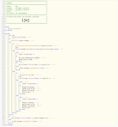

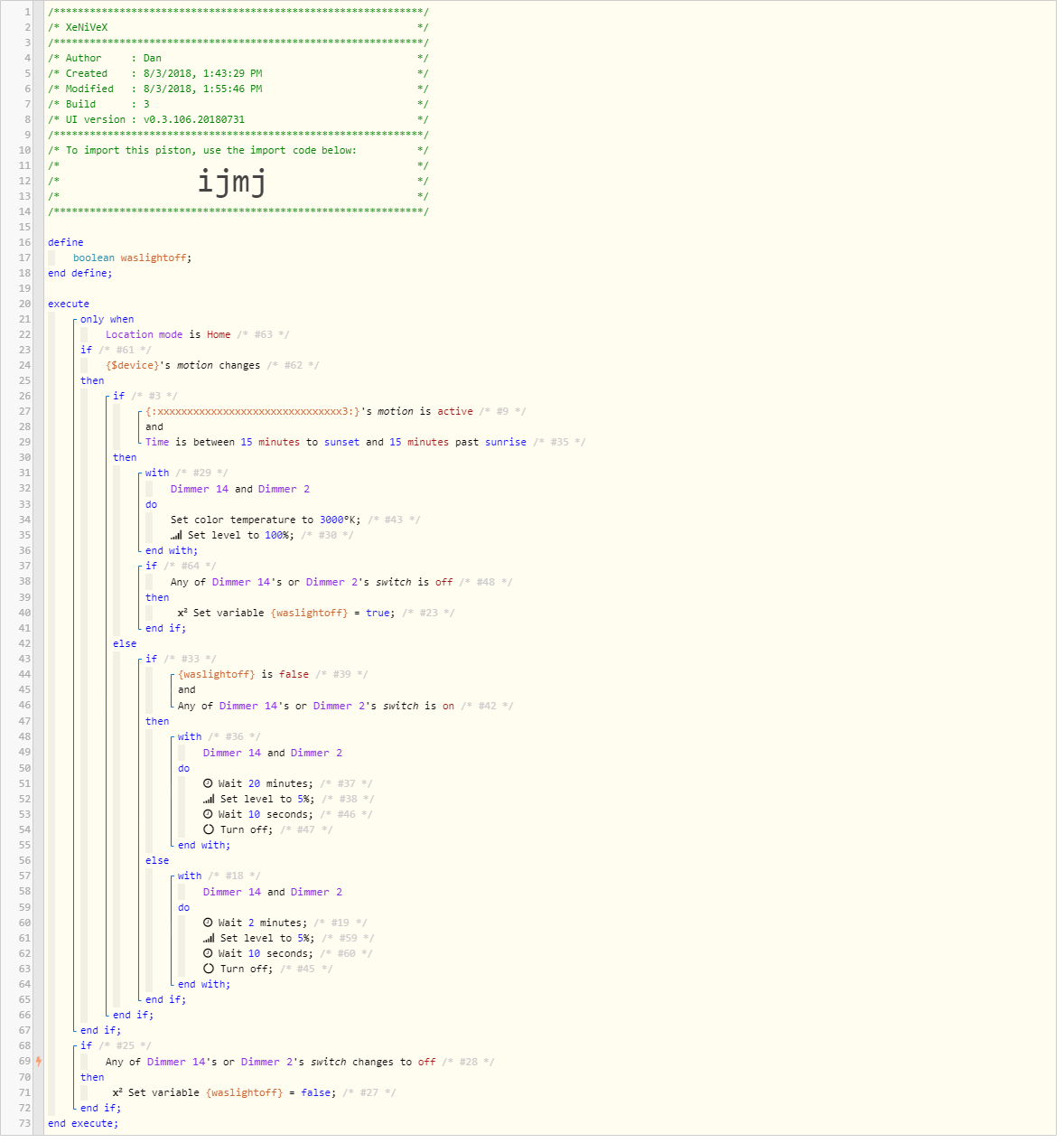

This is a slightly different approach using nested IF statements. More importantly it gets rid of the “if lights are off” conditional statement that prevents your lights from turning back up to 100% but keeps your ‘waslightsoff’ variable working the way you want it to.
I don’t have a motion sensor to select from my device list, so you have to change line 19 from $device to your motion sensor.
Thats awesome thanks! Seems to be working well :grinning:
