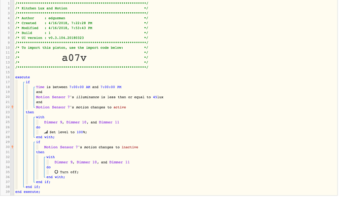

Help designing my first piston- newbie
(No problem. have not been able to test piston under current conditions.
(Would like for kitchen lights to turn on, on a cloudy day only if motion has been triggered and Lux is under 45 between 7 am and 7 pm )
(Just would like someone to take a peek at the piston and see how it looks )
looks great. just move the if block starting at line 29 to outside of the if block starting at line 17. that way it will work great too. :slight_smile:

Thank you! The light would go on when lux condition and motion was triggered, but for some reason it was not turning lights off after motion changed to inactive. Then I did what you suggested with bring out line 29 outside of the line 17 if block and the lights went off after no motion!!

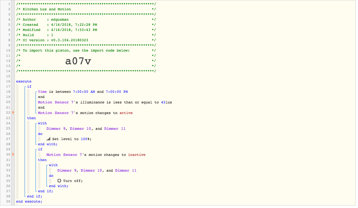

sorry this is the screen shot I meant to upload.

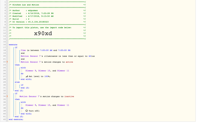

those this look better?
Looks good!

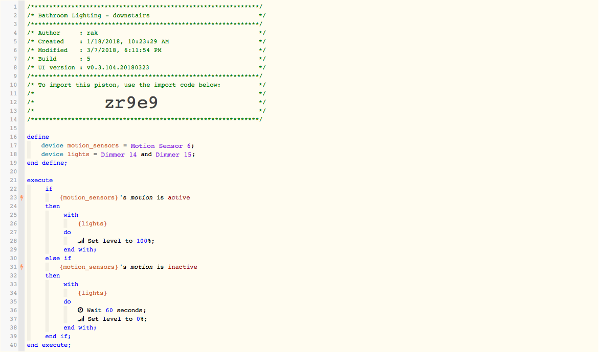

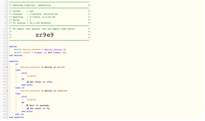

Here’s a simple piston I use for my bathroom which uses a “wait”… works well.
