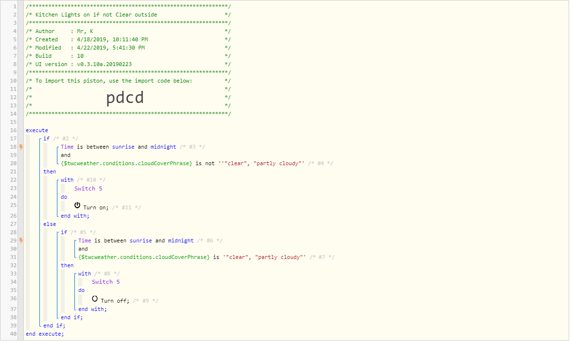

Help fixing Weather lighting piston
First part of piston is working but second (else) does nothing. Please help

I believe this will help. Remove your " " from your IF line 20 and 31

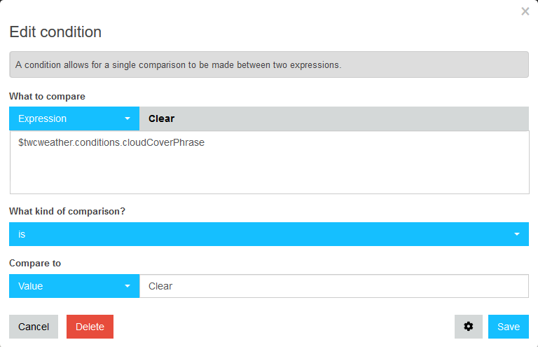

I think you can only compare the $twcweather.conditions.cloudCoverPhrase to one string at a time. If you want the switch on when the CoverPhrase is “clear” or “partly Cloudy”, use two if statements with an OR between them. You also do not need the second if statement at all, just use the else statement and turn the switch off with it.
If CoverPhrase = “Clear”
or
if CoverPhrase = “partly cloudy”
Then do
Turn On
Else
Turn Off
I believe @PhilR is correct. I cannot get it to work with “Clear, Partly Cloudy”
Everything’s working perfectly now, thank you for all your help.
