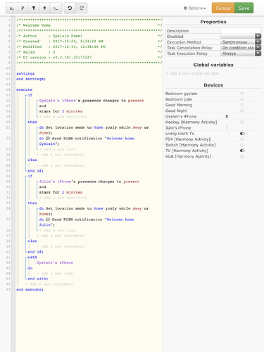

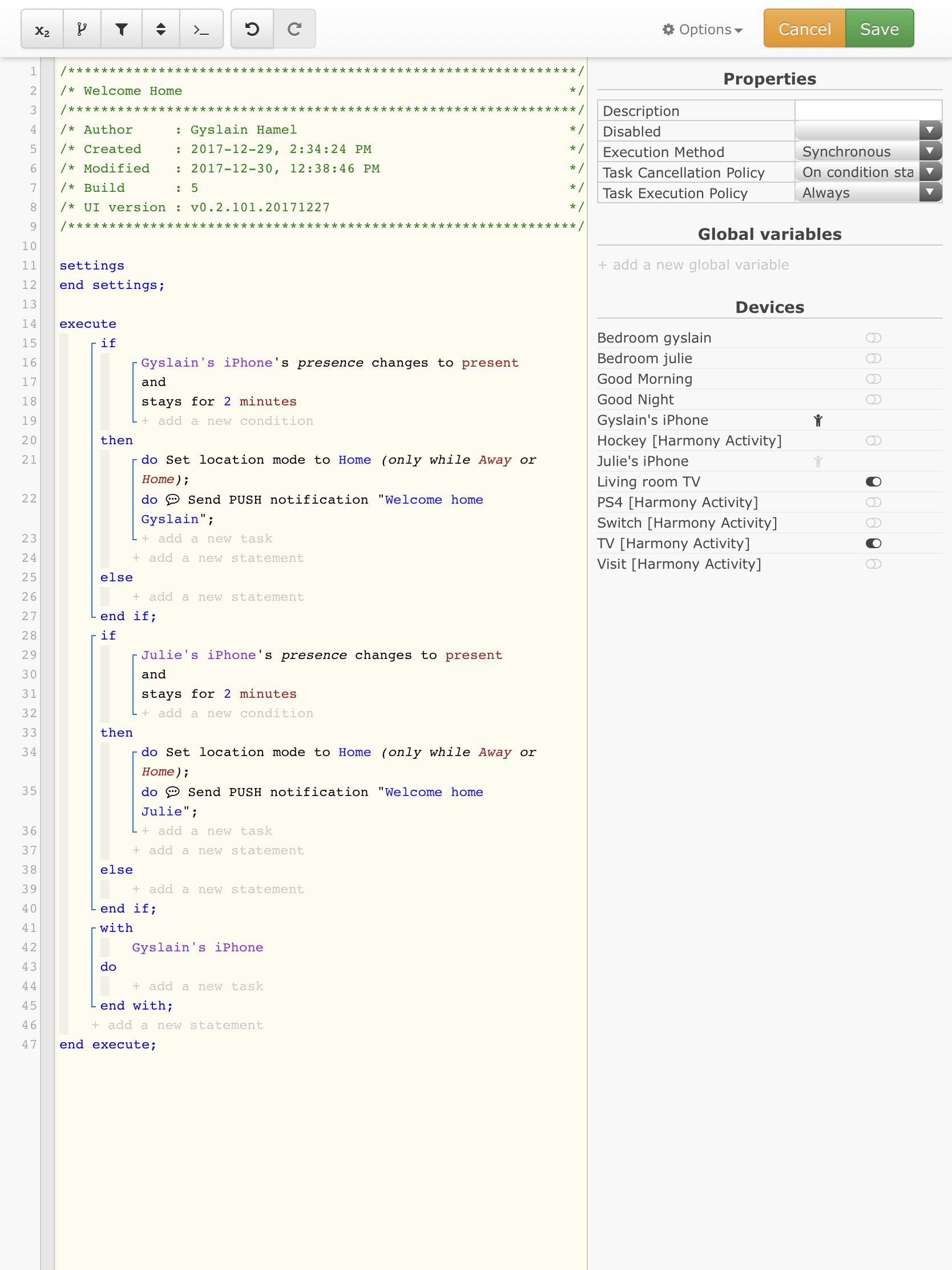

So what I want to do is, if my phone of my gf home change from non present to present and stay present for st least 2minutes, it changes from away to home and give a message depending who it is.
I also want this to work if the mode is home aka If I’m home and GF arrives
I want it to welcome her
Thanks
Click on the AND between changes to present and stays present for 2 minutes… Change it from AND to FOLLOWED By.
The presence cannot change and stay for two minutes at the same time.
You can also just eliminate the changes to and keep the “stays present for 2 minutes”.
I wrote the following then noticed that @michicago beat me to it whilst I was trying… what the hell, I’ll reply anyway lol
Each of your blocks has two triggers in the IF’s (changes to and stays)… these two triggers cannot happen at the same exact time so your piston will never fire.
You only need the one IF for each block (stays present for 2 minutes).
If I change the and to followed by it now says follows whiting 1 min by stays for 2 min
What should I put there
Just reduce it down to one IF…

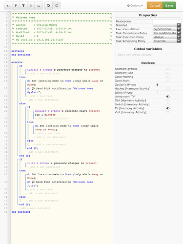

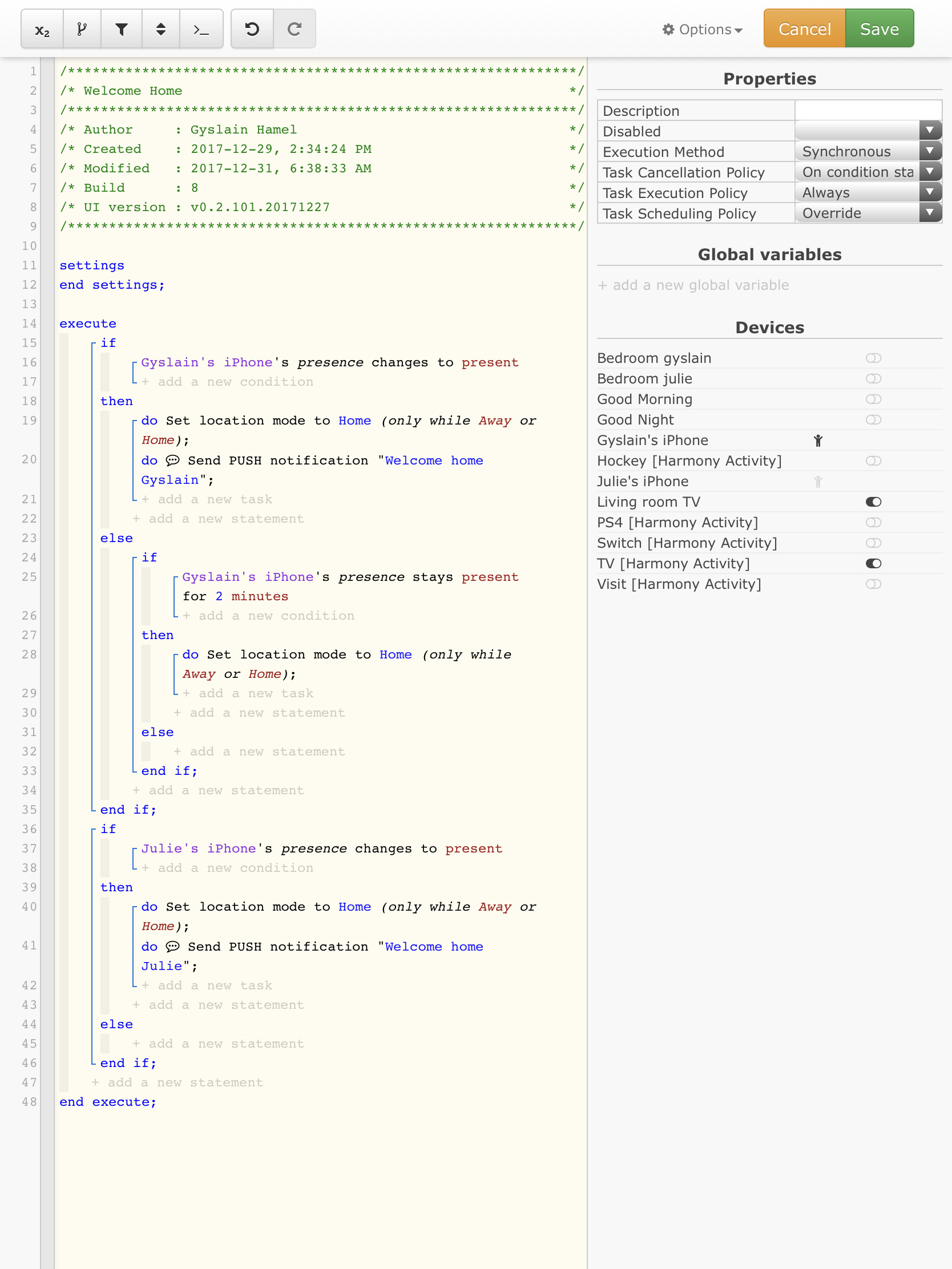

I modified the Gyslain part, would this work or would I nee to put the stays present in an indépendant if?
Maybe I’m trying to think this too many human and not enough computer?
Because what it was doing is, how the GPS report my location was if I get out my parking slot it considérés me away and if I move a lit5le I’m considered present again, so I wanna make sure that the presence change from non present to present AND stays present for 2 minutes before it sends the notification.
I also wanna make sure that AFTER 2 minutes of stay in presence ( after being in non present it change the location to home)
