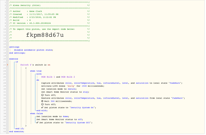

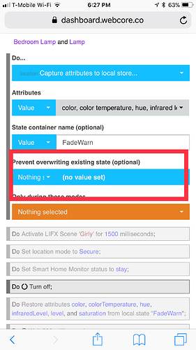

Light attributes aren’t being restored properly

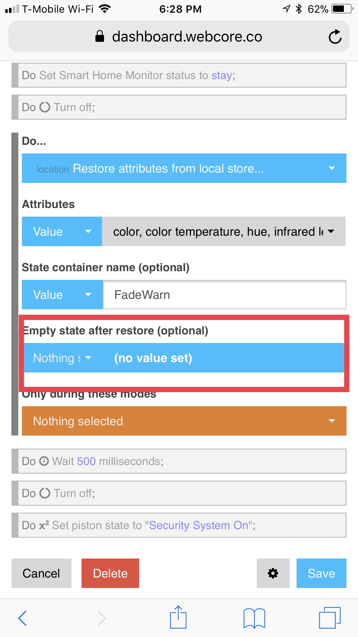

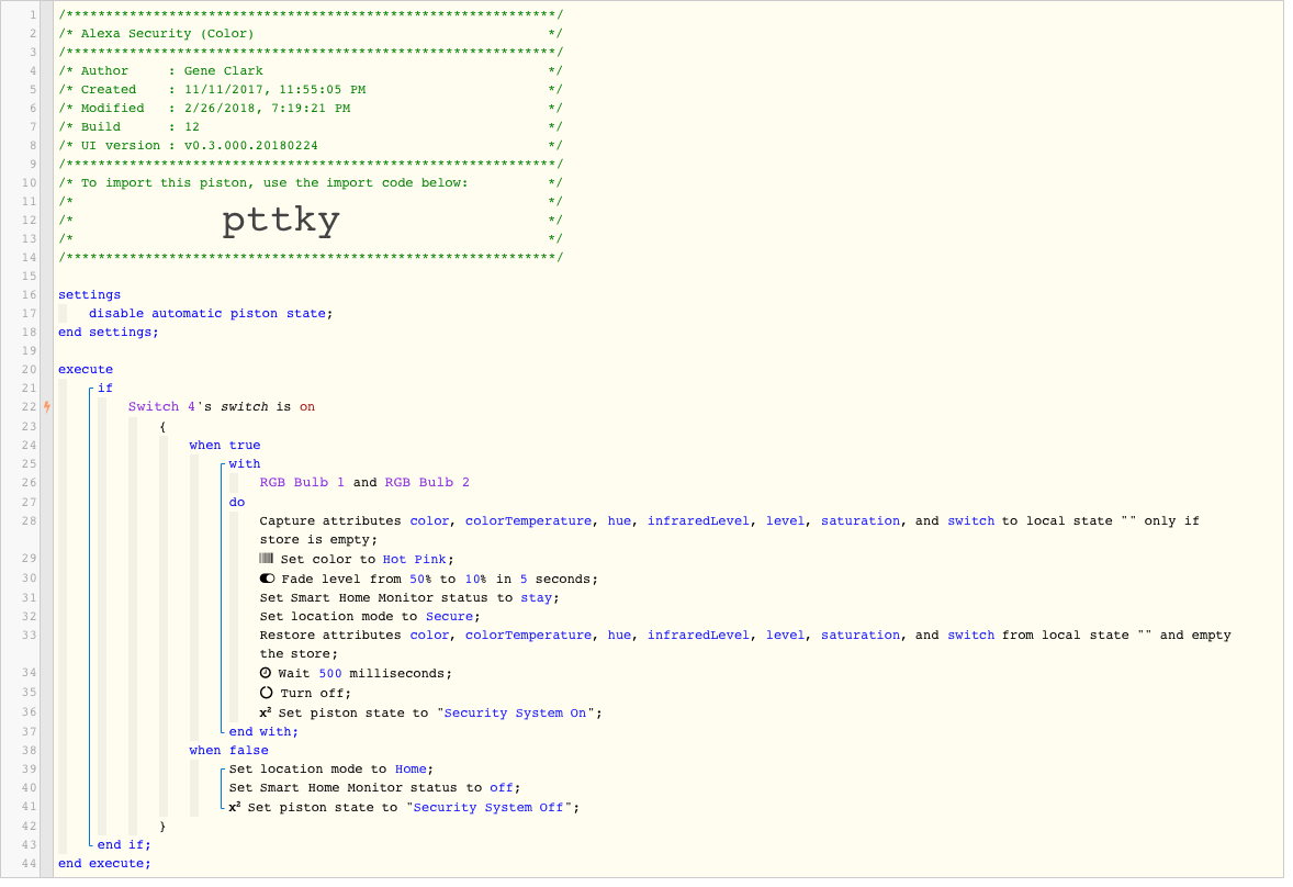

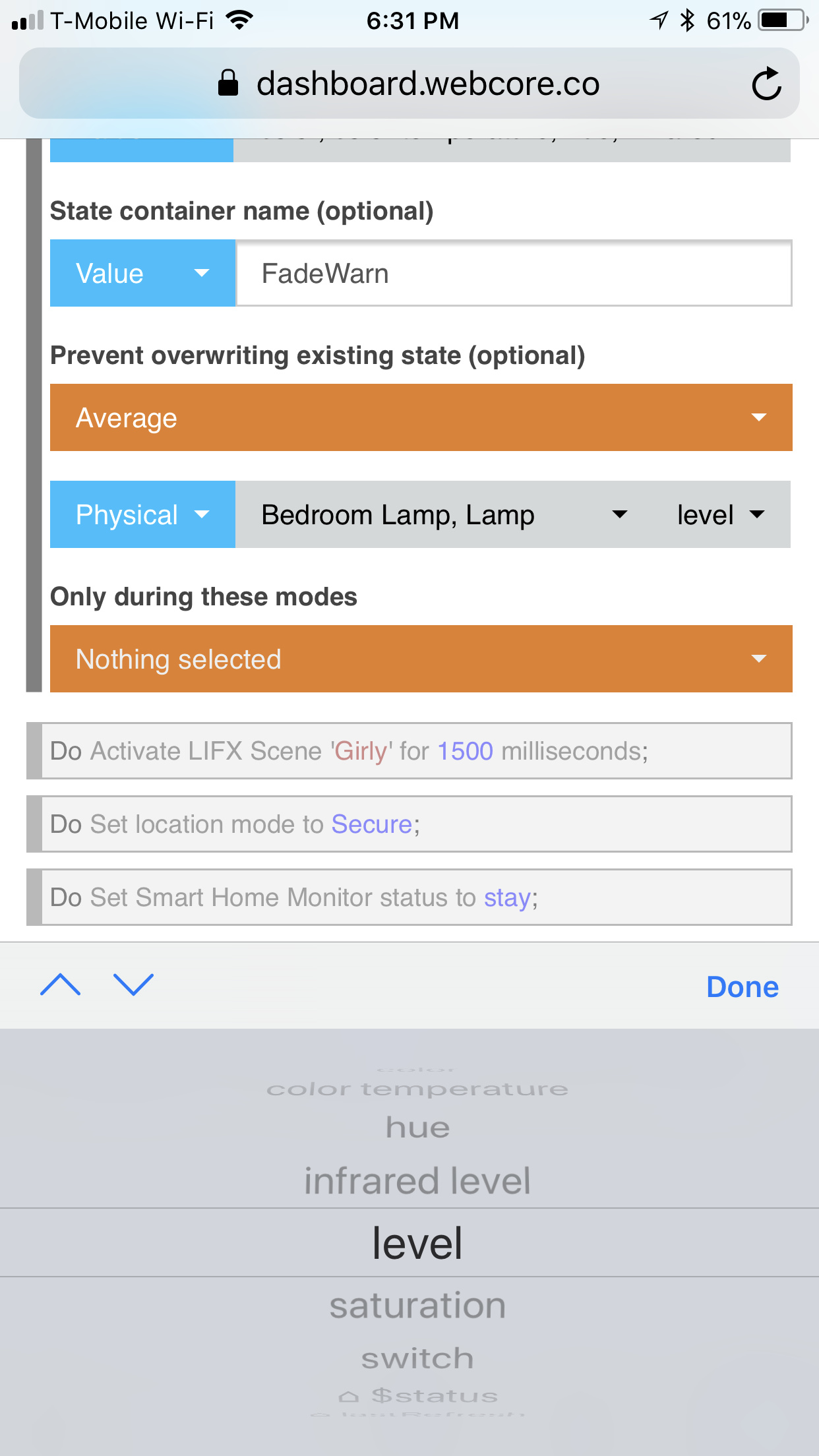

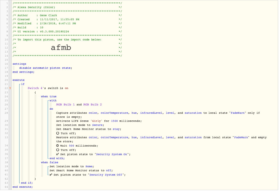

Wish to capture light attributes of color, temperature and brightness at beginning of piston and then restore at end to original state
Not going back to original state - if light was on before it does come back on at end and brightness doesn’t get restored

2/26/2018, 3:14:07 PM +98ms
+1ms ╔Received event [Security System].switch = on with a delay of 84ms
+122ms ║RunTime Analysis CS > 15ms > PS > 72ms > PE > 34ms > CE
+124ms ║Runtime (42102 bytes) successfully initialized in 72ms (v0.3.000.20180224) (122ms)
+136ms ║║Comparison (enum) on is (string) on = true (2ms)
+138ms ║║Cancelling condition #2’s schedules…
+140ms ║║Cancelling statement #3’s schedules…
+164ms ║║Executed virtual command [Bedroom Lamp].saveStateLocally (16ms)
+182ms ║║Executed virtual command [Lamp].saveStateLocally (16ms)
+1661ms ║║Executed virtual command [Bedroom Lamp, Lamp].lifxScene (1474ms)
+1662ms ║║Waiting for 1500ms
+3225ms ║║Executed virtual command [Bedroom Lamp, Lamp].setLocationMode (58ms)
+3236ms ║║Executed virtual command [Bedroom Lamp, Lamp].setAlarmSystemStatus (9ms)
+3241ms ║║Skipped execution of physical command [Bedroom Lamp].off([]) because it would make no change to the device. (3ms)
+3241ms ║║Executed [Bedroom Lamp].off (4ms)
+4307ms ║║Executed physical command [Lamp].off() (1064ms)
+4308ms ║║Executed [Lamp].off (1065ms)
+4327ms ║║Restoring attribute ‘color’ to value ’ #7F7F7F’ using command setColor( #7F7F7F)
+4348ms ║║Executed physical command [Bedroom Lamp].setColor([ #7F7F7F]) (20ms)
+4358ms ║║Restoring attribute ‘colorTemperature’ to value ‘5500’ using command setColorTemperature(5500)
+4410ms ║║Executed physical command [Bedroom Lamp].setColorTemperature([5500]) (52ms)
+4420ms ║║Restoring attribute ‘hue’ to value ‘33.3333333333’ using command setHue(33.3333333333)
+4466ms ║║Executed physical command [Bedroom Lamp].setHue([33.3333333333]) (46ms)
+4476ms ║║Restoring attribute ‘infraredLevel’ to value ‘’ using command setInfraredLevel()
+4482ms ║║Skipped execution of physical command [Bedroom Lamp].setInfraredLevel([]) because it would make no change to the device. (5ms)
+4491ms ║║Restoring attribute ‘level’ to value ‘100’ using command setLevel(100)
+4497ms ║║Skipped execution of physical command [Bedroom Lamp].setLevel([100]) because it would make no change to the device. (5ms)
+4507ms ║║Restoring attribute ‘saturation’ to value ‘’ using command setSaturation()
+4532ms ║║Executed physical command [Bedroom Lamp].setSaturation([]) (25ms)
+4533ms ║║Executed virtual command [Bedroom Lamp].loadStateLocally (221ms)
+4543ms ║║Restoring attribute ‘color’ to value ’ #ffffff’ using command setColor( #ffffff)
+4563ms ║║Executed physical command [Lamp].setColor([ #ffffff]) (19ms)
+4572ms ║║Restoring attribute ‘colorTemperature’ to value ‘5500’ using command setColorTemperature(5500)
+4616ms ║║Executed physical command [Lamp].setColorTemperature([5500]) (43ms)
+4626ms ║║Restoring attribute ‘hue’ to value ‘61.4221408407721’ using command setHue(61.4221408407721)
+4847ms ║║Executed physical command [Lamp].setHue([61.4221408407721]) (221ms)
+4857ms ║║Restoring attribute ‘infraredLevel’ to value ‘’ using command setInfraredLevel()
+4863ms ║║Skipped execution of physical command [Lamp].setInfraredLevel([]) because it would make no change to the device. (5ms)
+4872ms ║║Restoring attribute ‘level’ to value ‘100’ using command setLevel(100)
+4879ms ║║Skipped execution of physical command [Lamp].setLevel([100]) because it would make no change to the device. (6ms)
+4888ms ║║Restoring attribute ‘saturation’ to value ‘’ using command setSaturation()
