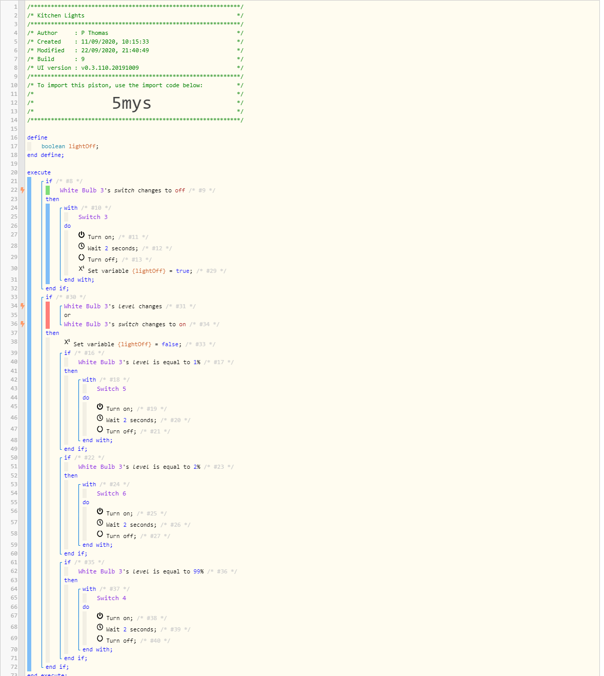

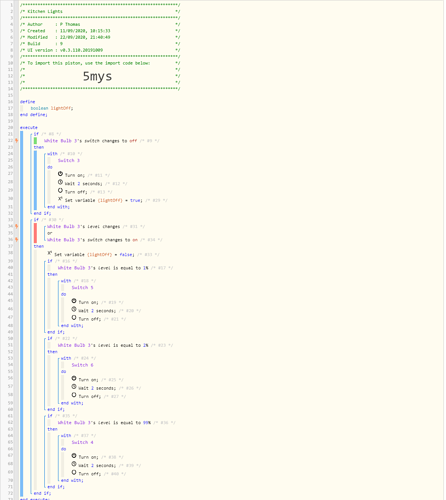

Well, I think sleeping on it was a good idea. I’ve probably been over complicating things and going against what the DH does. In effect, I was trying to make the turn on command change the level to 100%, rather than just turning on at the current level.
The following piston seems to be working fine, it should handle the on & dim commands in any order.
The next step would be to set the sim switch to on or off if the dimmer was operated manually. I could do this by monitoring the power usage. However, its quite expensive to add a power module, and then wire it into the consumer unit.

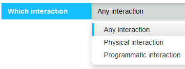

Do the physical/programmatic feature work correctly? I’m thinking if I used the physical interaction in my piston, then if I changed the switch via webcore (when power increases/decreases) it wouldn’t trigger? It would be a bit easier & more elegant to code.
Um… wouldn’t a simulated switch (by definition) only be toggled programmatically?
(I mean, how can you physically touch something that does not exist?)
yes, I’m not sure, so why does it have the two options? I guess operating it via the St app could be classed as physical?
In reference to this:
The interaction option (physical or programmatic) is webCoRE’s code, but it only works on the devices that report accordingly.
So if ST set the flag at the event, it could likely be picked up…
Although the usual remedy for this is to use variables
in webCoRE to distinguish between the two events.
It seems a very useful facility. I tried using it when I first started using webcore, but haven’t found any devices that support it. I’ve used variables since. I wish more devices would support it as it would lead to more elegant and simpler looking code.
