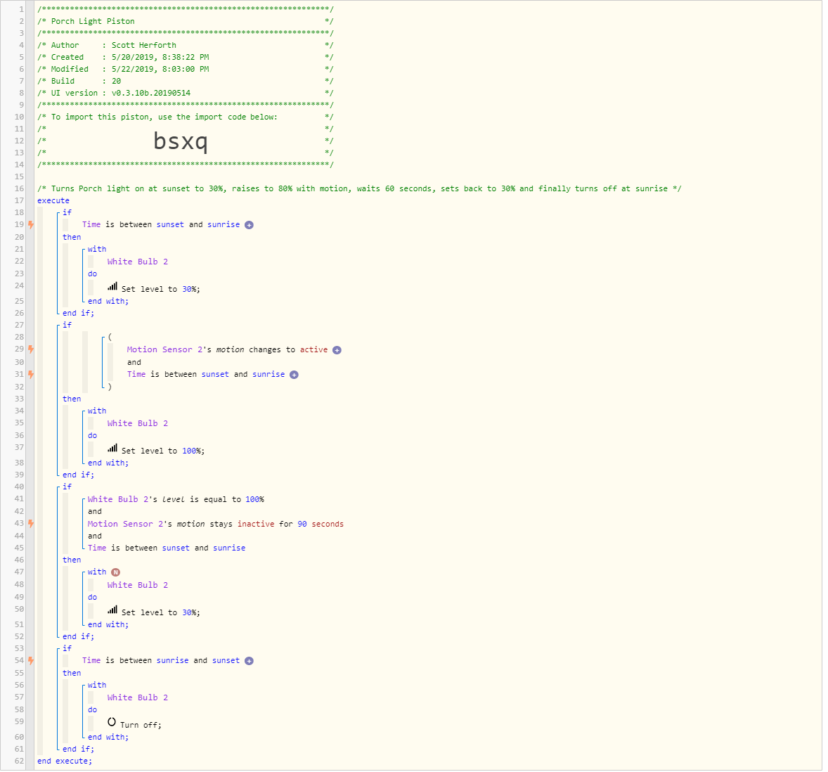

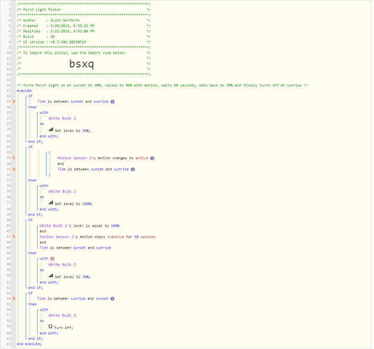

With Stringify going away I needed an app to handle those flows. After Googling I found so many referencing webCoRE. Researching I can see it can do everything I need plus a LOT more. Now it’s just a learning curve. I picked what I thought would be an easy first piston. It involves a Smartthings motion sensor and a Cree Connected Zigbee light.
Expected behavior is:
Light turns on at sunset to 30%
If motion changes to active then set to 100%
After 60 seconds of no motion set back to 30%
At sunrise turn off light
Light turns on at sunset to 30% - working
If motion changes to active then set to 100% - working
After 60 seconds of no motion set back to 30% - not working
At sunrise turn off light - working
The greenshot I’m posting is the current version after many other failed attempts. What is happening is no matter where I put the 60 second wait or other changes I make the light always goes back to 30% after 20 seconds which is when the motion sensor resets to no motion.
