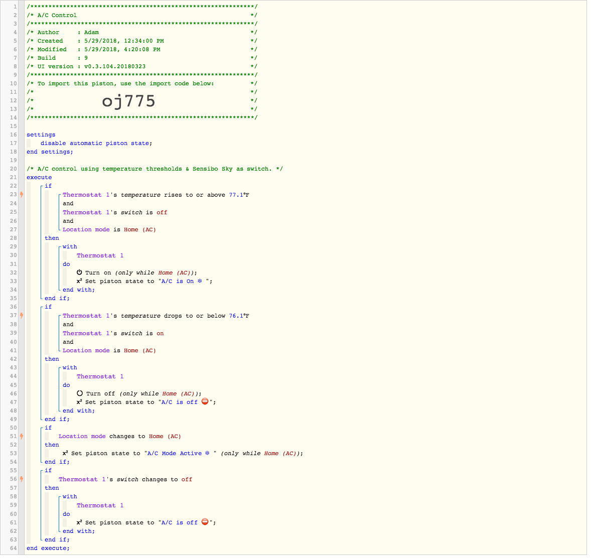

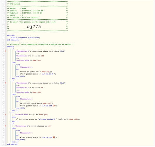

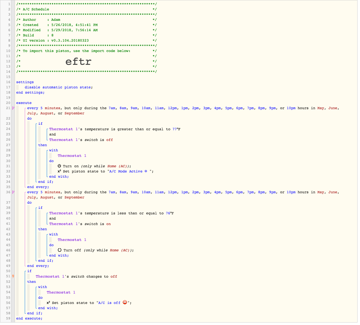

I have this setup to control my air conditioner based on temperature, but I’m looking to streamline it and/or restrict it to only run when the mode is Home A/C. Right now it runs every 5 minutes for the set time, but can I make it only poll when the mode is Home A/C?
Working as expected, but I’d like to slim it if possible.
Trying to get it to run / poll only during Home A/C mode
