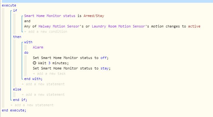

Temporarily disable alarm system when motion is detected from 1 of 2 sensors inside the home. Then reenable the alarm. This prevents the alarm from going off “if” we were to open the door from the inside.
If alarm is armed at home and motion is detected, disable the alarm for 3 min, then set BACK to armed/stay.
Problem is that when it is “waiting” to renable the alarm, if motion is detected again, it cancels the existing job and never re enables the alarm because the first IF is not true.
