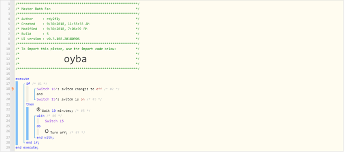

Simple piston that was working flawlessly all of a sudden is unpredictable

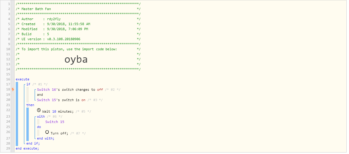

If Master Bath Light is turned off, and Master Bath Fan is left on, wait 10 minutes, then turn Master Bath Fan off.
Was working great, then within this last week sometimes now it doesn’t work more often than it does.

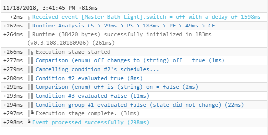

Here is a log example of normal behavior:

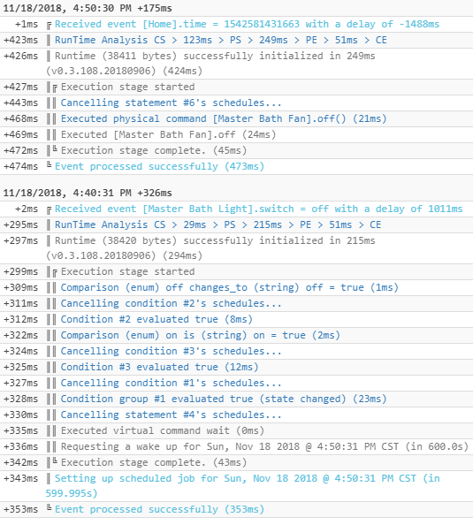

But here is a log example of what normally seems to happen. It shows on the very first line that it received Master Bath Light is Off, but it cancells condition #2:
