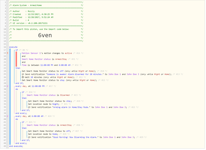

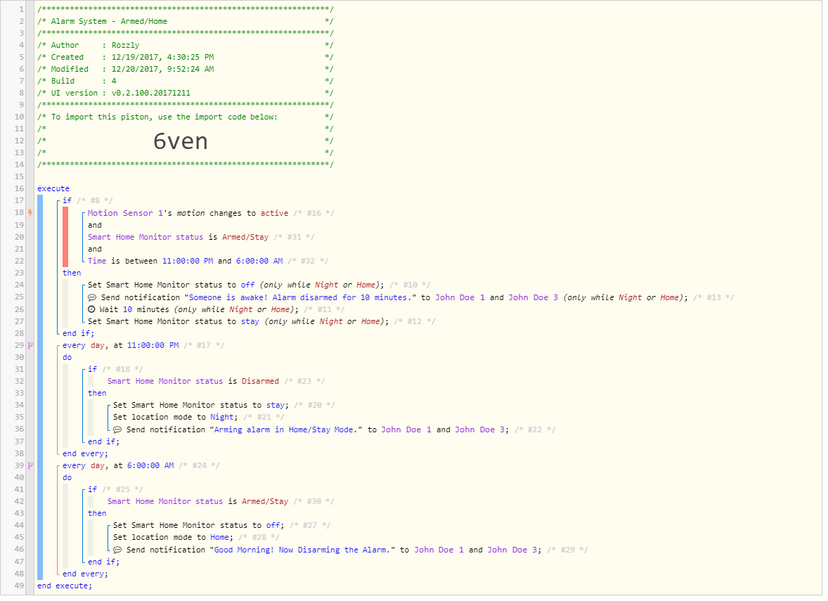

See below for the script. Both timed events trigger at 11PM and 6AM correctly, and the alarm will disarm itself if motion is detected within those times, but it does not re-arm as intended with a 10 minute wait.
- I’m open to additional suggestions; My next step is figuring out how to NOT set the alarm off if someone opens a window or something after hours.
Alarm will re-arm itself after 10 minutes of detected activity.
Alarm is not re-arming
12/21/2017, 11:54:33 PM +710ms
+1ms ╔Received event [Kitchen Motion Detector].motion = active with a delay of 100ms
+139ms ║RunTime Analysis CS > 14ms > PS > 13ms > PE > 112ms > CE
+142ms ║Runtime (44145 bytes) successfully initialized in 13ms (v0.2.100.20171211) (141ms)
+143ms ║╔Execution stage started
+150ms ║║Comparison (enum) active changes_to (string) active = true (0ms)
+152ms ║║Cancelling condition #16’s schedules…
+152ms ║║Condition #16 evaluated true (4ms)
+158ms ║║Comparison (string) off is (string) stay = false (1ms)
+159ms ║║Condition #31 evaluated false (6ms)
+160ms ║║Condition group #8 evaluated false (state did not change) (13ms)
+166ms ║╚Execution stage complete. (23ms)
+167ms ║Setting up scheduled job for Fri, Dec 22 2017 @ 6:00:00 AM EST (in 21926.123s), with 1 more job pending
+179ms ╚Event processed successfully (179ms)
12/21/2017, 11:16:17 PM +221ms
+1ms ╔Received event [Kitchen Motion Detector].motion = inactive with a delay of 111ms
+158ms ║RunTime Analysis CS > 21ms > PS > 22ms > PE > 116ms > CE
+163ms ║Runtime (44144 bytes) successfully initialized in 22ms (v0.2.100.20171211) (161ms)
+163ms ║╔Execution stage started
+170ms ║║Comparison (enum) inactive changes_to (string) active = false (1ms)
+171ms ║║Cancelling condition #16’s schedules…
+172ms ║║Condition #16 evaluated false (5ms)
+172ms ║║Condition group #8 evaluated false (state did not change) (5ms)
+178ms ║╚Execution stage complete. (15ms)
+180ms ║Setting up scheduled job for Fri, Dec 22 2017 @ 6:00:00 AM EST (in 24222.6s), with 1 more job pending
+189ms ╚Event processed successfully (188ms)
12/21/2017, 11:16:06 PM +22ms
+2ms ╔Received event [Kitchen Motion Detector].motion = active with a delay of 115ms
+166ms ║RunTime Analysis CS > 21ms > PS > 25ms > PE > 119ms > CE
+171ms ║Runtime (44147 bytes) successfully initialized in 25ms (v0.2.100.20171211) (168ms)
+171ms ║╔Execution stage started
+178ms ║║Comparison (enum) active changes_to (string) active = true (1ms)
+179ms ║║Cancelling condition #16’s schedules…
+180ms ║║Condition #16 evaluated true (5ms)
+188ms ║║Comparison (string) off is (string) stay = false (1ms)
+189ms ║║Cancelling condition #31’s schedules…
+190ms ║║Condition #31 evaluated false (10ms)
+191ms ║║Condition group #8 evaluated false (state did not change) (15ms)
+196ms ║╚Execution stage complete. (25ms)
+198ms ║Setting up scheduled job for Fri, Dec 22 2017 @ 6:00:00 AM EST (in 24233.781s), with 1 more job pending
+205ms ╚Event processed successfully (205ms)
12/21/2017, 11:16:01 PM +938ms
+1ms ╔Received event [Kitchen Motion Detector].motion = inactive with a delay of 112ms
+163ms ║RunTime Analysis CS > 18ms > PS > 20ms > PE > 124ms > CE
+167ms ║Runtime (44142 bytes) successfully initialized in 20ms (v0.2.100.20171211) (165ms)
+168ms ║╔Execution stage started
+174ms ║║Comparison (enum) inactive changes_to (string) active = false (1ms)
+175ms ║║Cancelling condition #16’s schedules…
+176ms ║║Condition #16 evaluated false (4ms)
+177ms ║║Cancelling condition #8’s schedules…
+177ms ║║Condition group #8 evaluated false (state changed) (6ms)
+183ms ║╚Execution stage complete. (15ms)
+184ms ║Setting up scheduled job for Fri, Dec 22 2017 @ 6:00:00 AM EST (in 24237.878s), with 1 more job pending
+227ms ╚Event processed successfully (227ms)
12/21/2017, 11:15:51 PM +814ms
+2ms ╔Received event [Kitchen Motion Detector].motion = active with a delay of 118ms
+171ms ║RunTime Analysis CS > 20ms > PS > 29ms > PE > 121ms > CE
+175ms ║Runtime (44146 bytes) successfully initialized in 29ms (v0.2.100.20171211) (173ms)
+183ms ║║Comparison (enum) active changes_to (string) active = true (1ms)
+184ms ║║Cancelling condition #16’s schedules…
+185ms ║║Condition #16 evaluated true (5ms)
+191ms ║║Comparison (string) stay is (string) stay = true (1ms)
+192ms ║║Cancelling condition #31’s schedules…
+193ms ║║Condition #31 evaluated true (8ms)
+199ms ║║Comparison (time) 83752007 is_between (time) 82800000 … (time) 21600000 = true (4ms)
+200ms ║║Time restriction check passed
+201ms ║║Cancelling condition #32’s schedules…
+202ms ║║Condition #32 evaluated true (9ms)
+203ms ║║Cancelling condition #8’s schedules…
+203ms ║║Condition group #8 evaluated true (state changed) (23ms)
+205ms ║║Cancelling statement #9’s schedules…
+216ms ║║Executed virtual command setAlarmSystemStatus (9ms)
+254ms ║║Executed virtual command sendNotificationToContacts (34ms)
+257ms ║║Executed virtual command wait (1ms)
+258ms ║║Requesting a wake up for Thu, Dec 21 2017 @ 11:25:52 PM EST (in 600.0s)
+262ms ║╚Execution stage complete. (86ms)
+264ms ║Setting up scheduled job for Thu, Dec 21 2017 @ 11:25:52 PM EST (in 599.994s), with 2 more jobs pending
+273ms ╚Event processed successfully (272ms)
12/21/2017, 10:59:59 PM +117ms
+0ms ╔Received event [Rozzly Home].time = 1513915200000 with a delay of -883ms
+135ms ║RunTime Analysis CS > 14ms > PS > 14ms > PE > 106ms > CE
+138ms ║Runtime (44140 bytes) successfully initialized in 14ms (v0.2.100.20171211) (137ms)
+180ms ║║Comparison (string) off is (string) off = true (2ms)
+182ms ║║Condition #23 evaluated true (8ms)
+182ms ║║Condition group #18 evaluated true (state did not change) (10ms)
+185ms ║║Cancelling statement #19’s schedules…
+195ms ║║Executed virtual command setAlarmSystemStatus (6ms)
+240ms ║║Executed virtual command setLocationMode (43ms)
+321ms ║║Executed virtual command sendNotificationToContacts (74ms)
+328ms ║╚Execution stage complete. (188ms)
+331ms ║Setting up scheduled job for Fri, Dec 22 2017 @ 6:00:00 AM EST (in 25200.553s), with 1 more job pending
+339ms ╚Event processed successfully (338ms)
