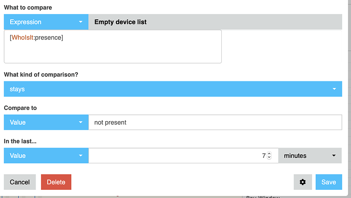

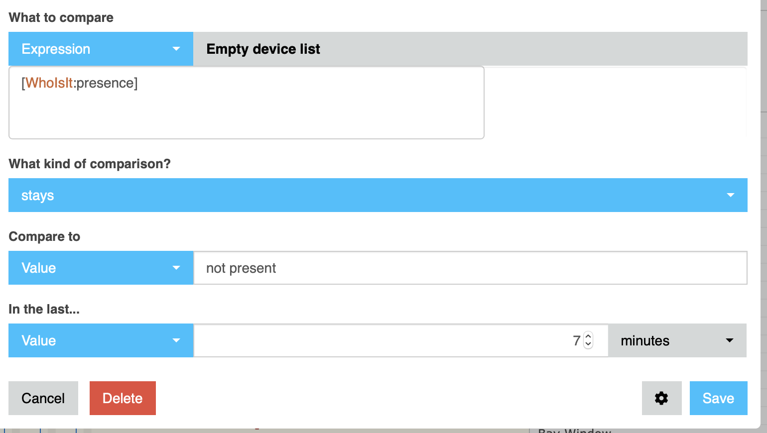

Thanks @ike2018. I’ve rearranged the piston based on your feedback, but I’m still unclear how to write the above IF statement.
What comparison would I be using to construct this statement?
right now, this is the best I’ve got. but I’m not sure the “stays” comparison is it.

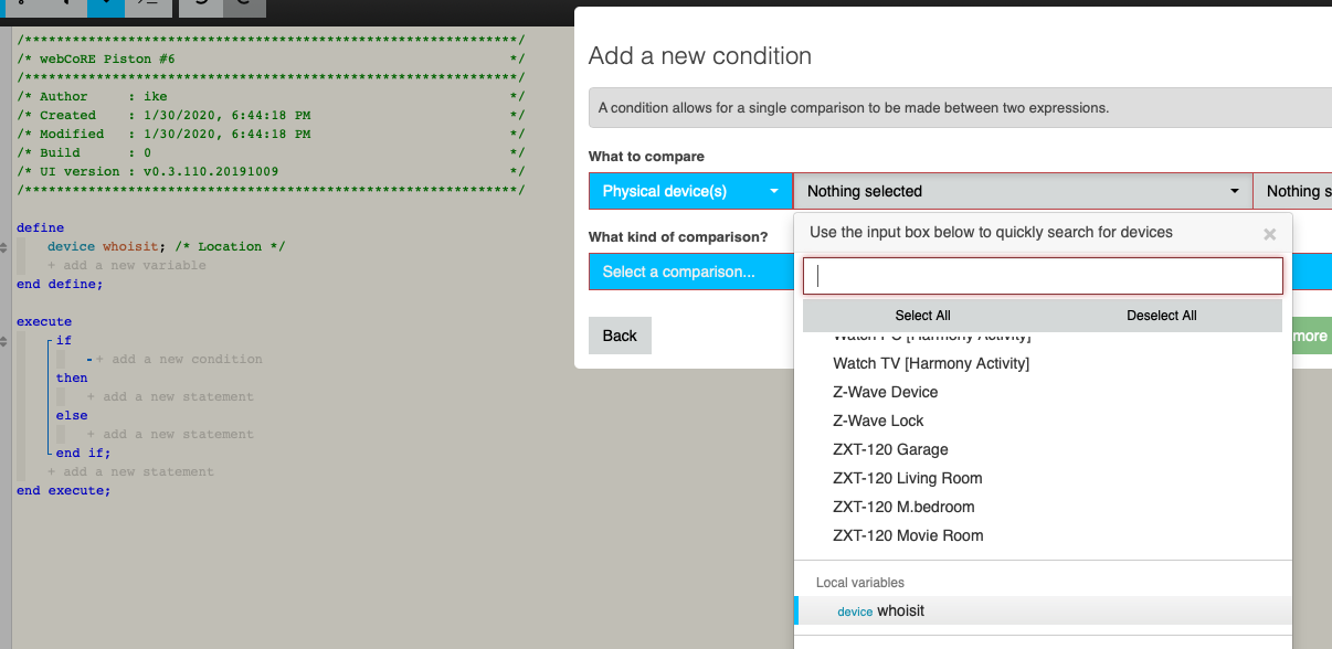

Instead of EXPRESSION (you don’t need that), click on the blue box and you should be able to see DEVICE
scroll all the way down (until your actual devices are over) you’ll see your variable
Select that as a device,

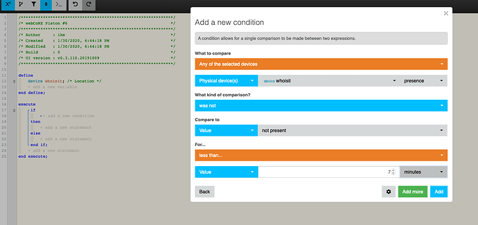

In the picture I made a mistake,
I chose WAS NOT, NOT PRESENT…
instead you choose WAS, NOT PRESENT
Oh! Yes. You are a maestro. Thank you.
I’ve got it now. Let me see if that does the trick on the false alarms.

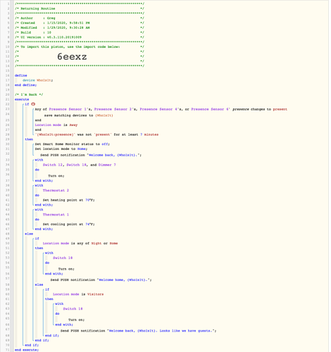

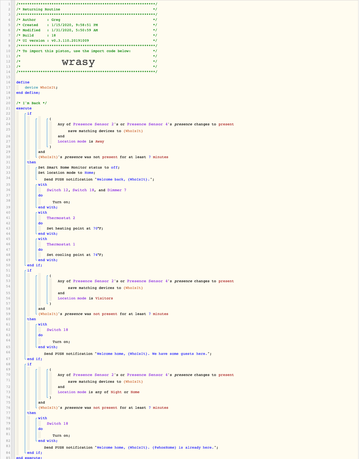

Piston is updated. I’ve attached the new version below.
This is probably more of a general WC question. But as you can see, now I have 3 IF statements within the same piston. Is it best practice to be setting the same variable from similar IF statements like this? Will this cause collisions?
Or should this be nested in a different way?
When 3 statements are in the same array (it think it’s an array), do they operate sequentially where the first statement has influence over the following statements? Or are they 3 distinct statements?

I am not really in a position to comment on best practice as I really haven’t written an awful lot of pistons in the grand scheme of things. My particular focus is not so much what works, but why it works. So it was particularly welcome to see a piston where my initial reaction was “I didn’t think that would work, but it does” and so be able to improve my understanding (*).
I don’t see any issue with your grouping of the ‘if’ statements. It could perhaps be argued that it could be written more economically, but that is just one factor alongside ease of maintenance and ease of understanding. With your piston it is clear what is going on.
As for the conditions in your if block (array is probably not the best word but block is just a word I plucked out of the air in desperation, as when an if condition is made up of conditions that are conditions or triggers, you run out of unique terminology rather quickly), to the best of my knowledge they do get evaluated in sequence, so yes they can affect the next condition.
(*) It was the ‘was’ condition that had me pondering. If you wrote a piston including, but not being triggered because of, if sensor presence was not present for at least 7 minutes, it would return false if the current state was present. So I was wondering why it didn’t when looking at a list of devices that had all just changed to present. The ‘was’ comparison works by looking at the list of previous events from the device. It turns out it first checks if the current event involves the device attribute it is comparing, and if so it skips the first event. So the ‘was’ refers to how things were before the current run of the piston. Which is probably obvious to some.

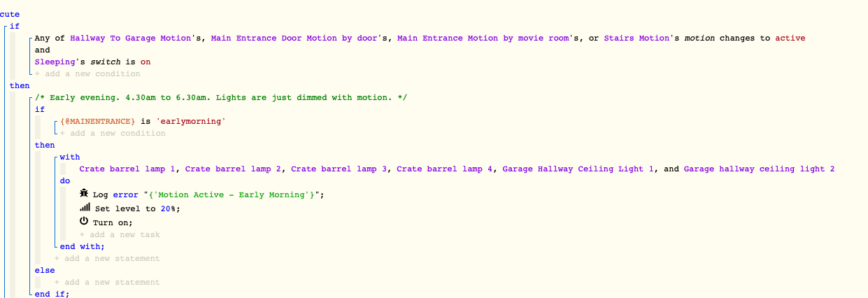

Here is an example from my home:
I admit, I try to teach during the process, but ultimately, the final decision is always up to the home owners… (a lot of my tips & guidance may be based on past issues I have encountered)
