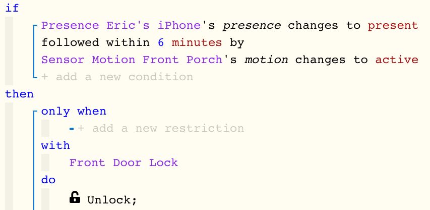

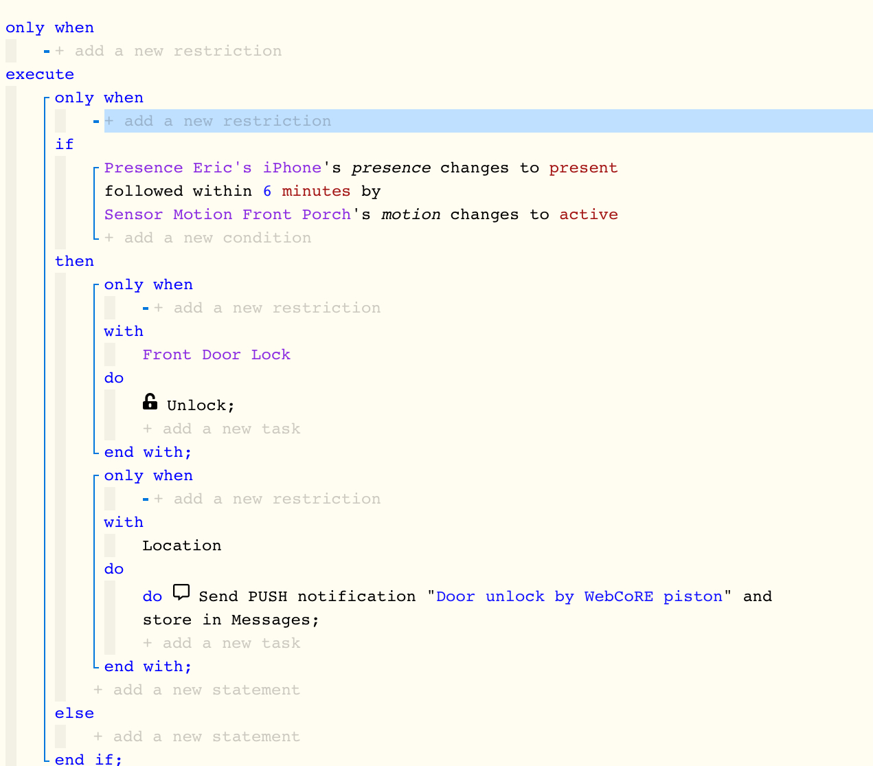

Looking for help. This piston isn’t unlocking the door like I want it to.

@Eric182, I will help you here with this caveat…search recent discussions about presence sensors and webcore. Some have great results with their sensors. Others, like me, have terrible response times and therefore my presence sensor is nearly useless for time sensitive webcore pistons. I won’t even talk about the security issues with unlocking a door with your phone.
Now, first, you need to remove all of your “only when” statements. Your code should look like this (untested) :
IF Presence Eric's Phone presence changes to present followed in 6 minutes by
Sensor Motion Front Porch motion changes to active
   THEN
      With
         Front Door Lock
            DO
               Unlock
      END With
      Send PUSH notification "Door unlocked by WebCoRE piston" and store
END IF

EDIT:: isn’t that what I already have?
The line: “followed within X minutes by” never seems to be reliable, so I have stopped using that logic entirely, and resort to using variables.

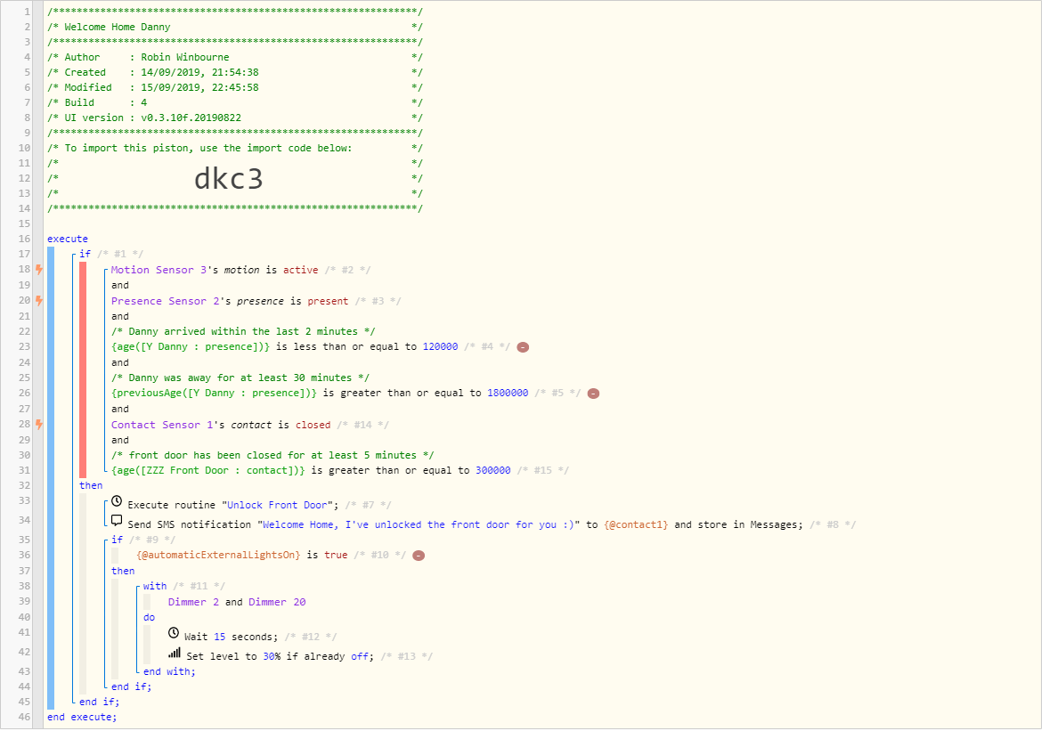

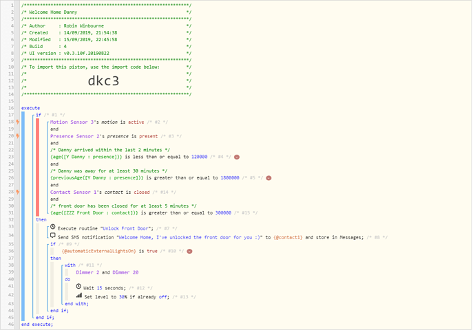

I wrote the following piston for my brother, it has a stack of safeguards as noted in the piston comments… we can’t afford to have the door unlock by accident as it’s designed to pop open as well (it’s a disabled access thing that I don’t fully agree with), thus cannot be re-locked remotely
I check door is actually closed, and has been closed for at least 5 minutes, in-case my he arrives too fast / piston has a delayed execution. He could open the door manually with his fingerprint, close it behind him and not notice it has re-opened behind him as he walks away.
I check he arrived within the past 2 minutes so as to be less than the 5 minute requirement on the door being closed (piston can therefore only fire once per arrival)
I check he has been away for at least 30 minutes, because the zigbee mesh is weak and the ST arrival sensors currently have a habit of dropping off the grid for 5-10 minutes at a time (soon to be improved with a stack more Hive plugs to act as repeaters).
A LOT of thought needs to go into a piston like this!!!
  • Motion sensor is a ring video doorbell
  • Contact sensor is the front door
  • The variable @automaticExternalLightsOn is just a global marker that I use across 20+ pistons for when it’s dark, linked to sunset / sunrise with offsets… just means I can change the offset once in a single place.
  • The Unlock Front Door routine triggers another piston, which has a stack more safeguards lol
