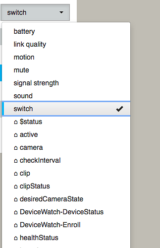

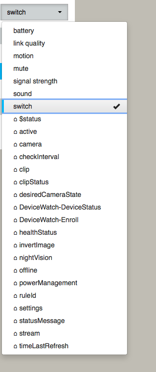

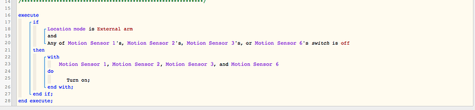

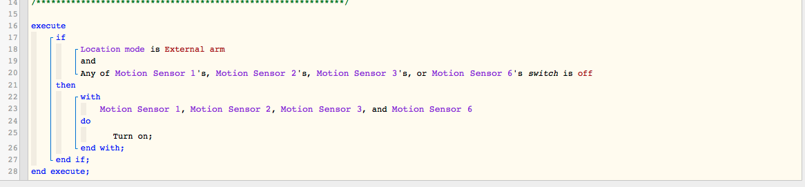

I am using Smarthings to set an alarm state for Arlo cameras depending on home/away etc.,.
Sometimes the cameras do not physically get turned on , and I want a piston to check
If in a certain alarm state. check to see if expected cameras are ON…if not turn them on
If I test it by going to the alarm state, and turning a camera off in the Arlo software, it does NOT get turned back on by webcore…Im not sure what state of the camera I should be checking for OFF
Ive tried switch , and camera but no go… Im sure I’m missing something really simple!
I have also added a screenshot of my options when checking camera state dropdown box
