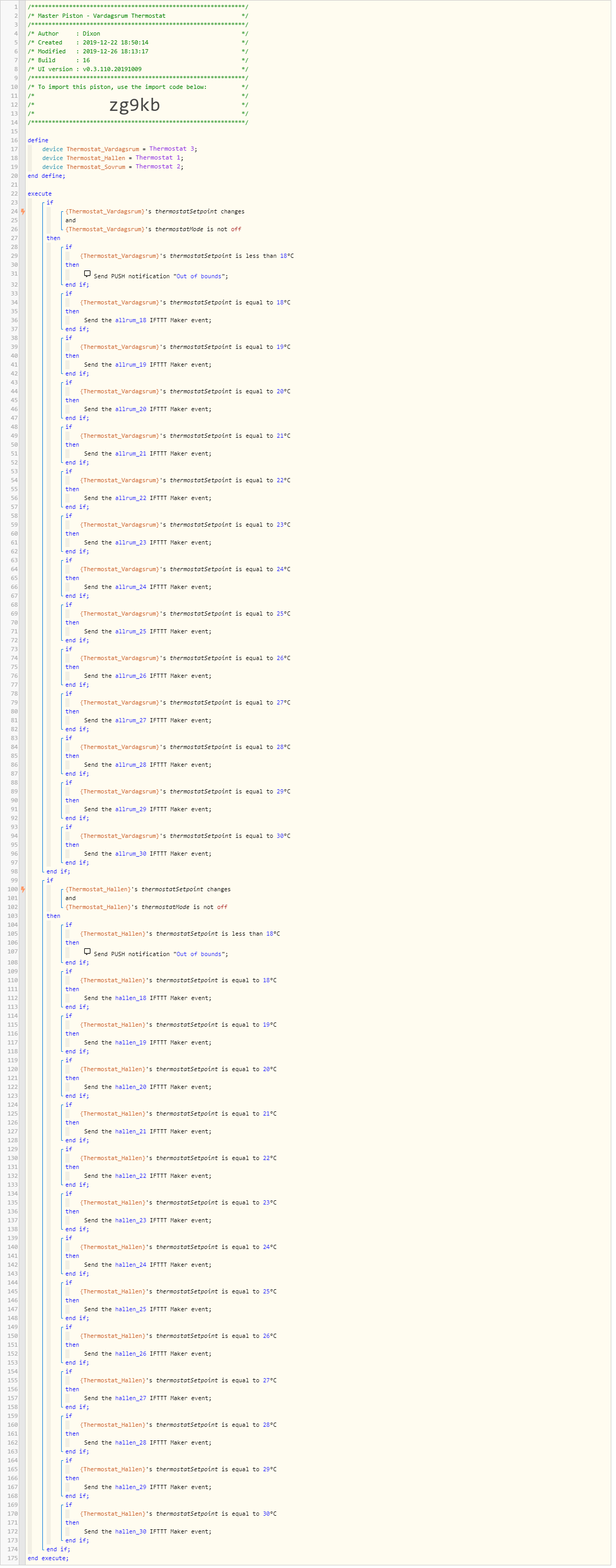

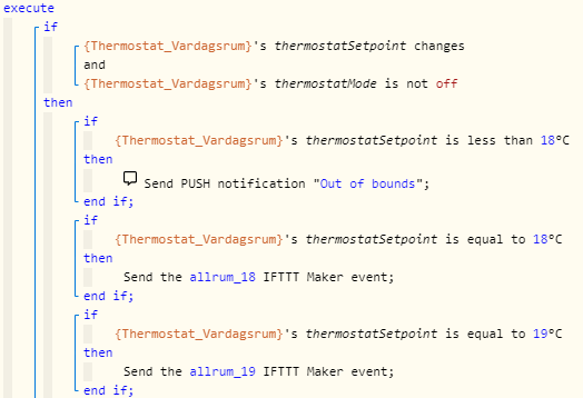

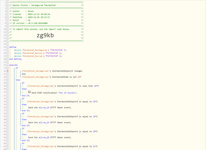

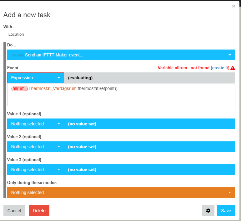

The piston does work but adding 3 more will make the piston cluttered real good, looking for suggestions / example on how to trim it down if its even possible?

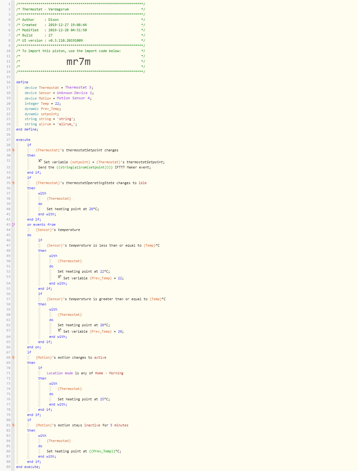

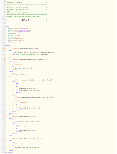

working as intended
