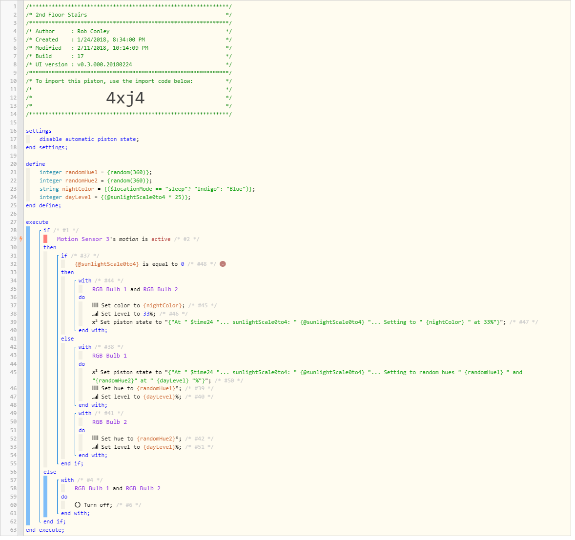

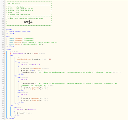

I have the same bulbs, and this is what I do. Not sure if it gets you where you want to be.
